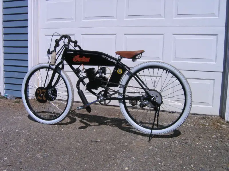

Just scored some Indian board track grips!!!
Thanks again to all who helped with this build esp Sportscarpat and Pirate Cycles without who the build would never have happened!
Just changed to cloth spark plug wire and scew on thumb cap like the orginals had.

Thanks to sportscarpats boardtrack "kits" i was able to build my dream bike. Im not a frabricator so there kits were priceless.

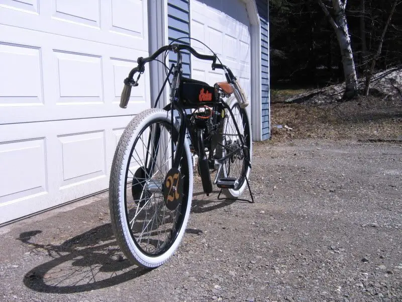

Ok all my secrets...Wire 7mm ebay...search cloth spark plug wire. The thumb screw 4 x .7 mm threads for a ngk plug. Avail at Lowes. The grips are actuall Indian grips....i paid dearly for them. Cool thing is i had a flat grip that slid inside the clutch side so it would fit the 7/8 bars. There both a little bigger than 1 inch but the throttle side fit fine. Had to shave the plastic throttle a little the grips are short and stubby.
Bars are Sportcarpats. Inserts for the holes are just black hole plugs again at Lowes.
The seat some english made thing that i thought looked kinda old.
White tires ebay again. Indian headbadge again Ebay, along with tank decals.
Did i miss anything???

Thanks for the info.! I think you covered it all, that's a great bike and is surely turning some heads. Next up will be the full on outfit, an old racing jersey and helmet, boots and gloves, oh yea and the goggles, gotta get the goggles!
