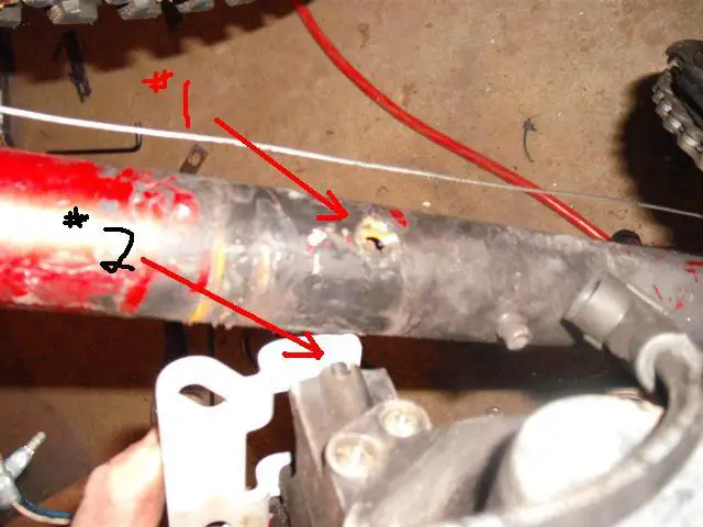

Yes the hole is in the side. Its where the SBP front mounts machine screw was rubbing the frame. I needed to check it for tightness fairly frequently. Then I neglected to and the SBP motor mount broke and took out a piece of the frame. Of this happened 25 miles away form home. The wife rescued me it was only an hour before she got off from work.

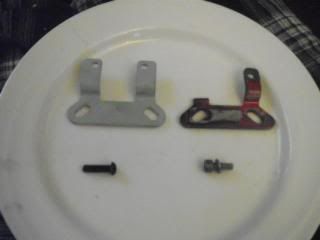

SBP has improved the design. New on the left and old on the right. Its larger and thicker metal now. There is also diff type screws that don't rub. At least in my case. I looked onto getting those screws all over town couldn't find any accept at Fastenal the only wanted to sell a box for over $20. In hindsight I should have done it. LOL

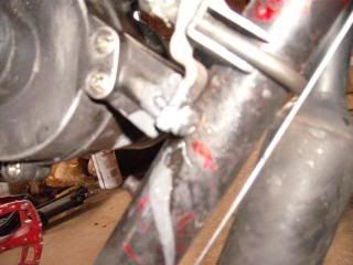

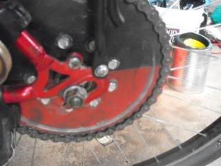

This was my Quick fix with JB Weld to go to a Job Fair. I've added more JB Weld since I took this pic. I didn't make it on the bike though the motor sprocket fell off again. Called wife for another rescue. It came off before but this time I've lost the wood ruff key!

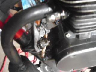

This is a pic of some oil spatter after I pedaled home when my sprocket came off. Not sure where it could be from either the head gasket or exhaust gasket. But I've got bigger issues now.
