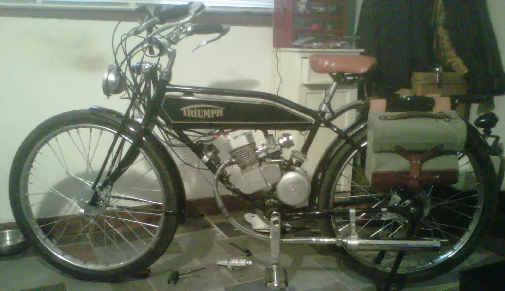

Ive been reading the posts andi need to ask some questions out to anyone who has and uses a centrifugal clutch kits
1)how much extra width do they need on the clutch side to clear the cranks?
2) I have 7/8" extra clearance to work with. The cover that comes with the kit seems to be deeper than it needs to be to cover the cetrifugal clutch. if the system exceeds 7/8", does it look like i could make a shallower centrifugal clutch cover to fit it in??
3) the pull start doesnt really go with the look im going for,
how tough is it to start the motor by pedaling? Because i have a SBP shift kit, and the rear wheel "freewheels" will i still be able to start the motor with just the momentum of the pedals?
thanks
