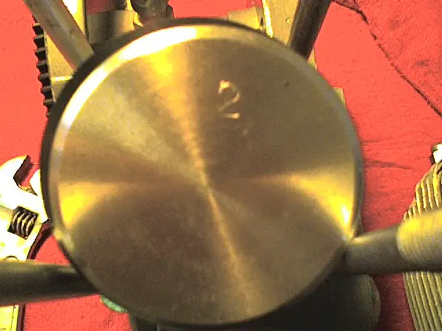

Took a close look at my generic "Pizhou Yongxing Gasoline Engine Factory" 80cc today. Although it has the slant head the piston does not rise above the jug at TDC. Also the piston has a flat top with the number "two" stamped but no arrow. It would seem there are destinctions between the PK-80 (also "Pizhou Yongxing Gasoline Engine Factory" ) and my less expensive generic. I just thought I would add to the data base.
Below: the bottom of my head after dremel and polish work. Also a couple pics of the motor straight from the box.

The piston has #5 and arrow on it.
I also notice the fins on the head are rounded more.

If you have a flat top piston i would get rid of the head gaskets.
Use the thinnest aluminum you can find to make a new one.

To see what piston you have turn the motor so the piston is at Bottom of stroke and look through the exhaust port.
Or just take the head off.
