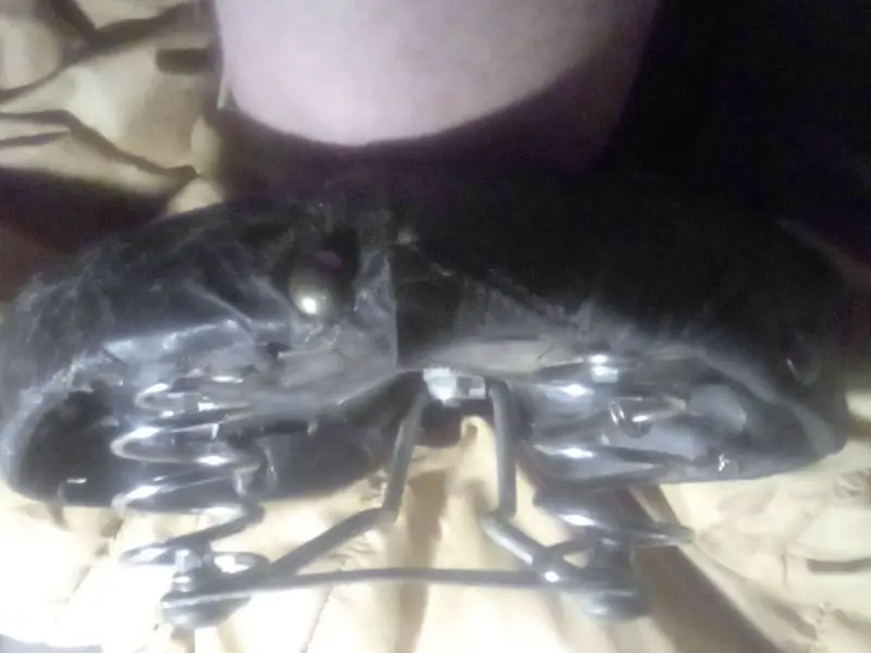

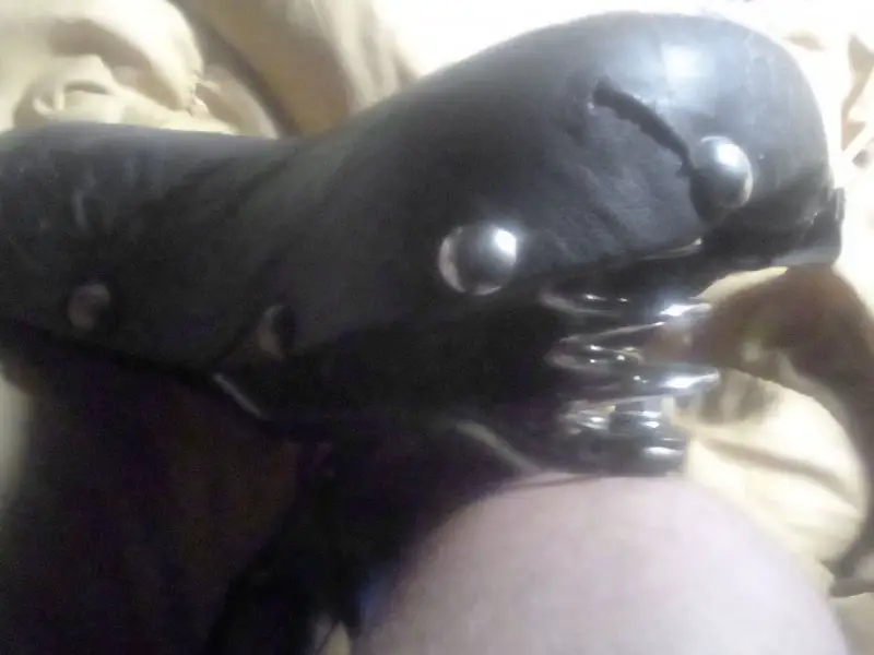

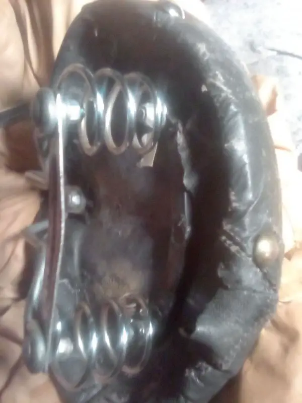

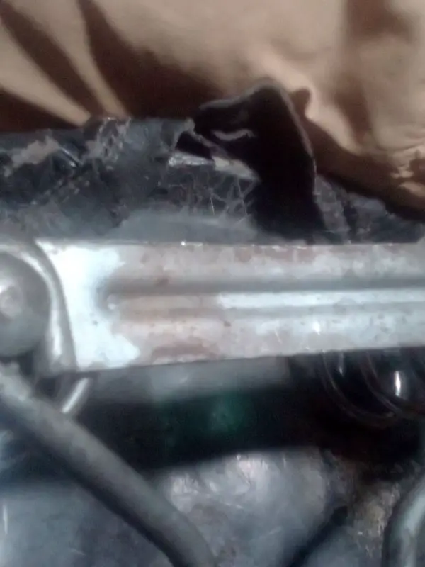

Comparing a saddle seat and bobber seat there isn't much difference EXCEPT the bobber seat typically shows more of the back seat springs so what I did was just trim the back of the bottom edge of the seat to expose the springs.
I ran out of hot glue but you can see how I trimmed the back of the seat down and made deep scratches in the plastic, from different angles to give the glue opposing directions to anchor to and along with the big anchor tacks are enough to keep it held together.
