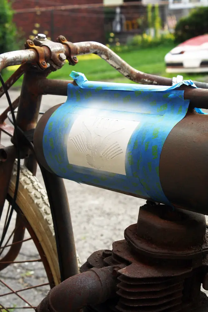

Step 2: Apply vinyl stencil and dust lightly with paint and let dry.

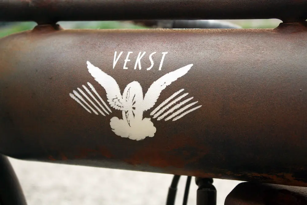

Step 3: Remove stencil. Looks pretty bad huh? don’t worry it’s intentional.

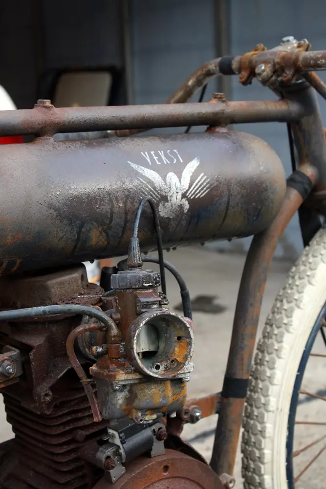

Step 4: Apply Iron oxide paint let dry and spray with rust activator.
Step 5: Let activator dry, then wash with water and let dry again.

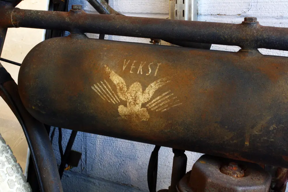

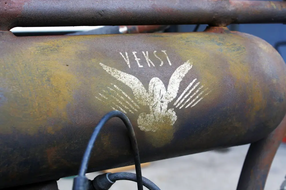

Step 6: Dust lightly with textured brown paint then soften the hard ares with base color blue in my case.
