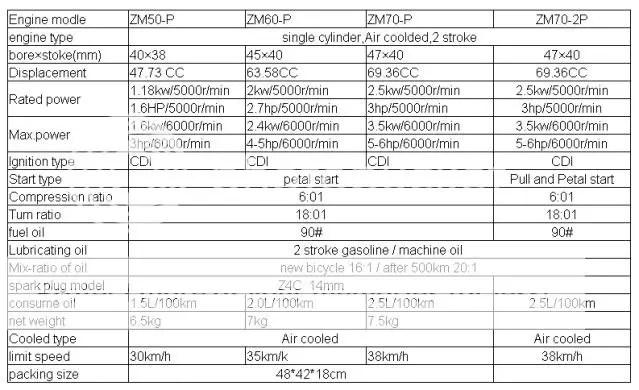

Copied from manufacturers site:
Notes:
1. As for the 80cc, in fact there is no such cc bicycle engine in china market, we called our 47*38(bore*stroke) engine F80 before ,but now we correct it, because its displacement is only 66cc(from EPA test report).
2. How to caculate the engine capacity. The fomula is listed below.
The volume of a cylinder=(bore area)x stroke
Bore area= Bore x Bore x pi / 4. (pi has a value of 3.14159)
Take our ZM70-P for example, its bore is 4.7cm(47mm), its stroke 3.8cm(38mm)
4.7×4.7÷4×3.14×3.8=66cc

Specifications from China are not accurate. The cc may or may not be correct, but the horsepower ratings are incorrect. These engines (66cc model) are most definitely under 2.5 horsepower maximum with a modified exhaust/ expansion chamber I believe.
You're right, I also found an updated version of this table that showed the compression being 8:1. I'm not sure if these guys can't comprehend math or not, because they obviously can manufacture an engine, but I can't see how their numbers would be so off between two different tables.
It also lists that the engine I have has a max speed of around 38kmh, which is not true. The bike will do a lot faster than this. I guess in China you just have to get it in the ballpark.
