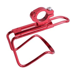

I just made a nice improvement to my custom fuel tank.
This fuel tank setup has proved very dependable since first putting it in service 2 years ago, but one slightly annoying problem that it shares with even the stock fuel tank, is that when it's filled to the top, you get a slight amount of leakage through the vent hole in the cap.
