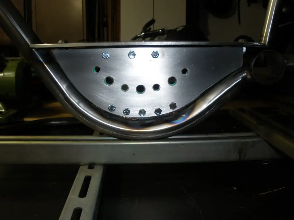

I have finished motor mount with the bottom plates. 13 inches from the plate to the bottom top tube, so don't get a motor too tall for this area.
The frame is just about complete unless I am requested to add something more.
Now to start the tank and and make the disk brake mount for the fork.
Wish I could keep this frame....lol
