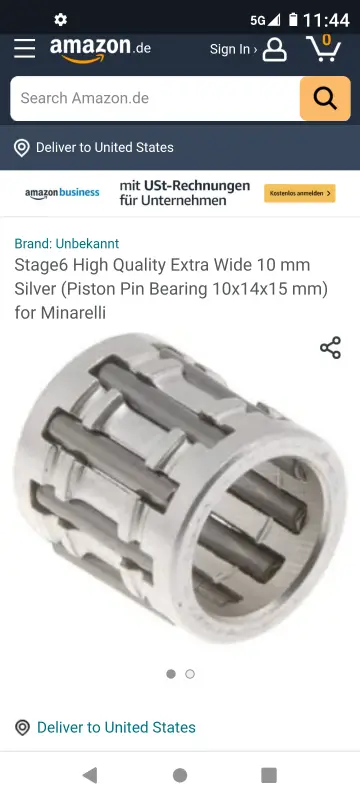

OK I found a good bearing for the piston top being 10X14X15 brass bearing from Amazon

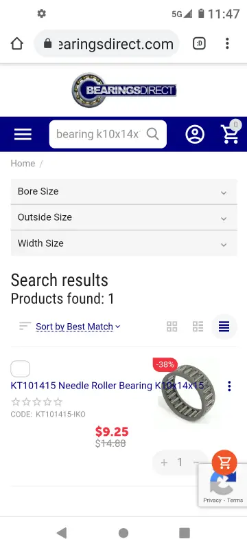

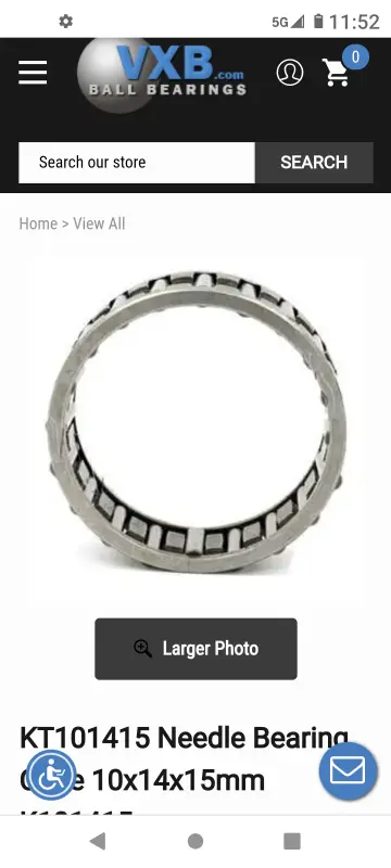

Not brass and the bottom bearing needs to be pressed in with a fixture to keep everything aligned or your going to be out of true.. wobling... VXB has your bearing... it's common KT101415
