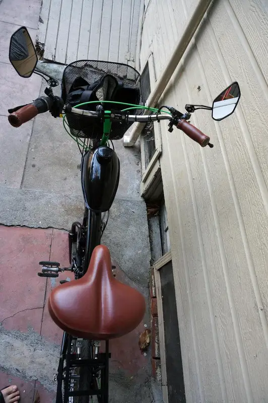

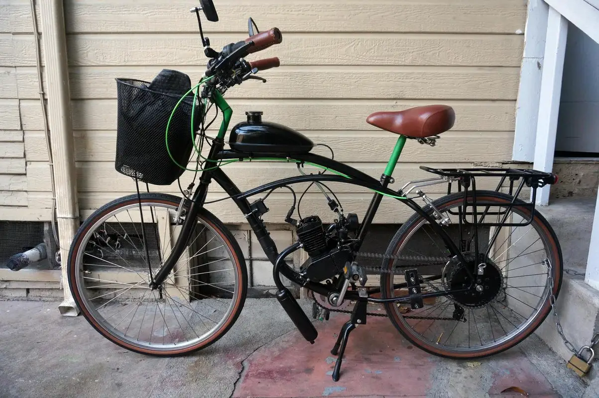

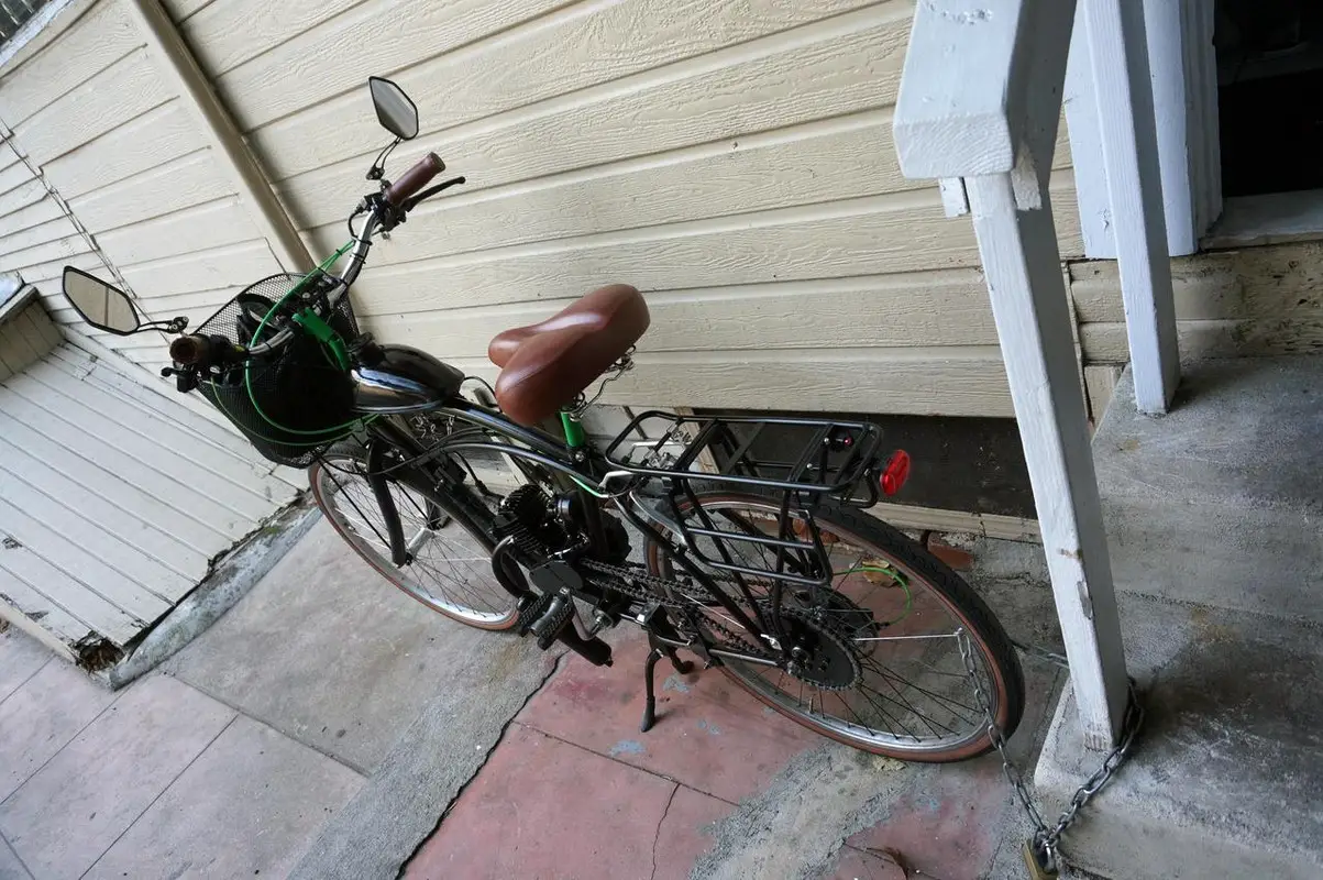

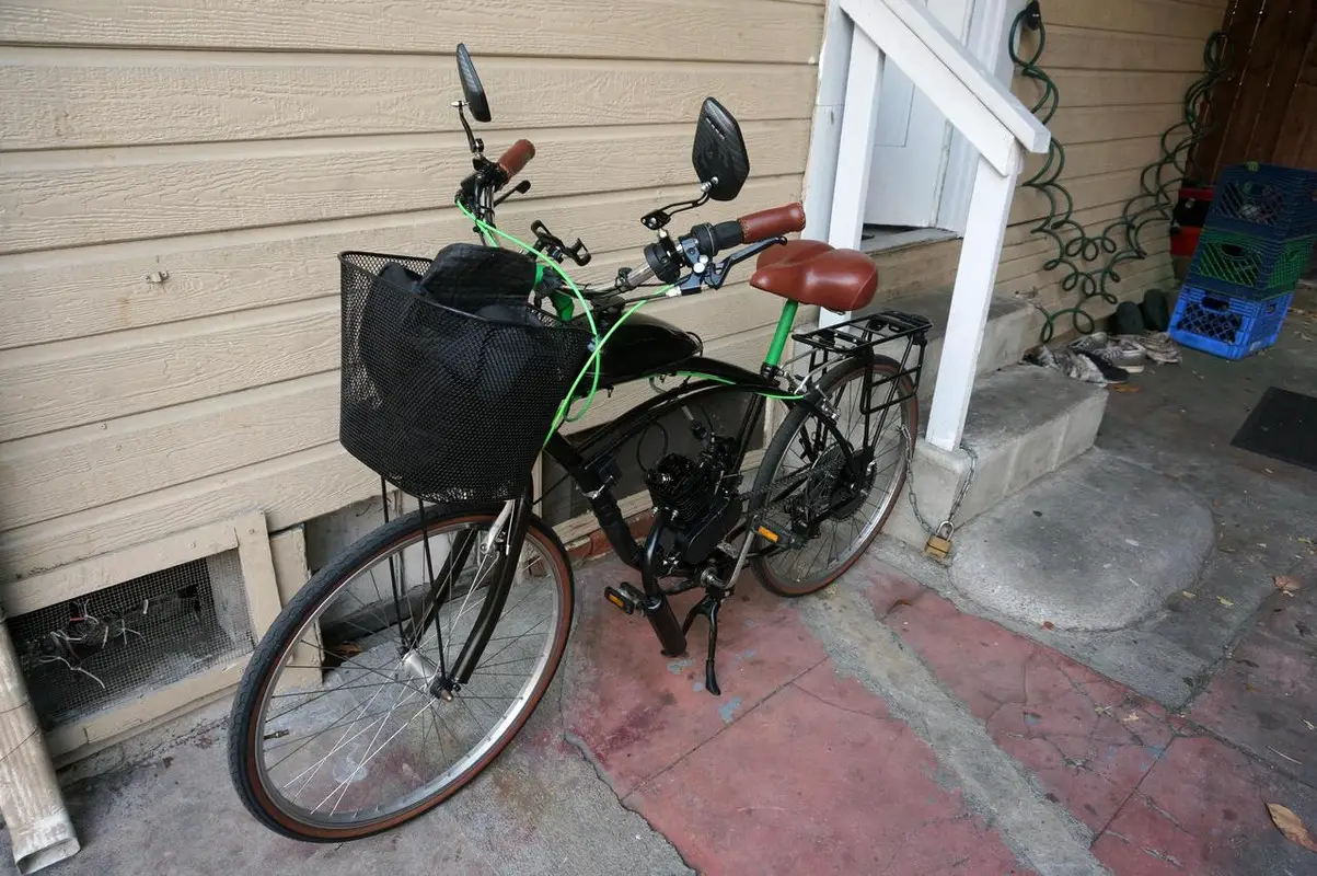

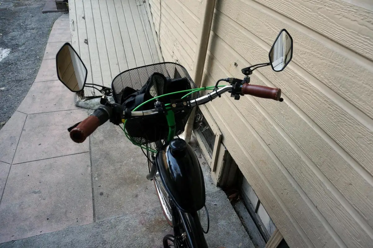

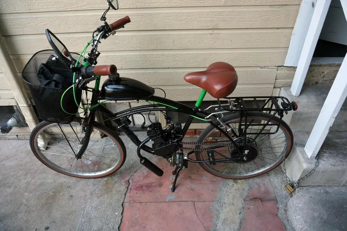

Finished my project today and its feels odd to ride it.
Very confusing when to pedal, when to clutch etc, plus i have 5 speed bike.
How long does it take on average until person learns it?
I decided to toss that kit in the trash after riding for a hour and keep the bike, or sell all together for $250.
