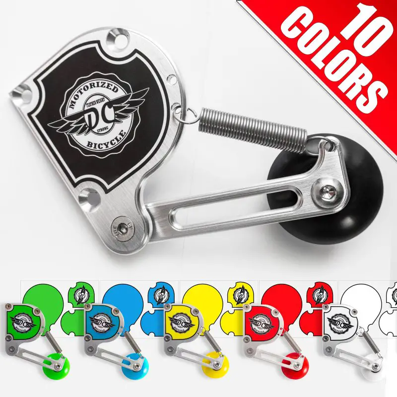

I believe that is what brought me into this new hobby... I love working on all our two stroke outdoor power equipment at work and seeing what I can tinker with to make stuff run better/smoother! Thank you for your response and as far as the tensioner are you talking about something like this...?

Or are you talking about one like this? And which one of these tensioners is better?

Yes any one with a skate board wheel on it. This one is far better in quality my opinion for 10 bucks more, better finish no sharp edges, countersunk allen head machine screws, lighter swing arm, abec sealed bearings, better spring, I use these on all my builds, they are so nice. Any one is far superior to original type in the kits.

Ok great I’ll look into this! Thank you Ziptie!
