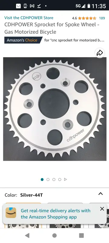

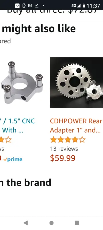

Some... LOL... kit chains... Get a quality chain... a CNC sprocket and hub adapter to fit your hub... 48t and there are larger ones for us bigger boned guys ;)
