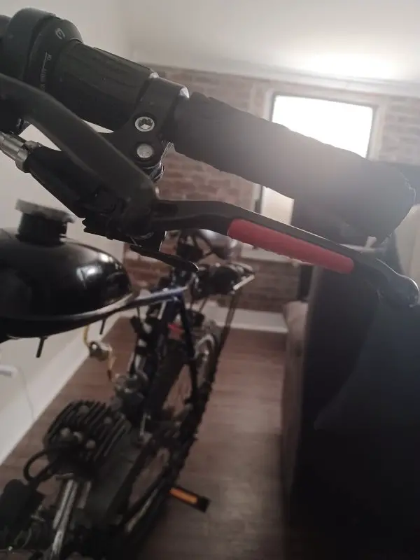

Not sure how to explain this but I have to push clutch all the way in for back wheel to spin there is very little play I mean all the way in can I get some feedback how to fix this? And thanks other than that that bikes running great
I can't really take a picture It is not a problem at the moment it's just I have to squeeze clutch all the way in and then some to pedal other wise the wheel does not turn

how do I do that maybe have to get a new cable cause all the nuts are adjusted all the way out
You can shorten the cable jacket to get more length out of the cable and put a new end on it... Start fresh with the nuts all the way in then pull the cable tight making sure the ends fit into the pockets then get it together and lock it down... Have a friend hold the cable with plyers as you lock it down... You should feel the slightest bit of tension on it
I have it locked on last slot the back wheel will not turn is it my cable or clutch and how do I fix it

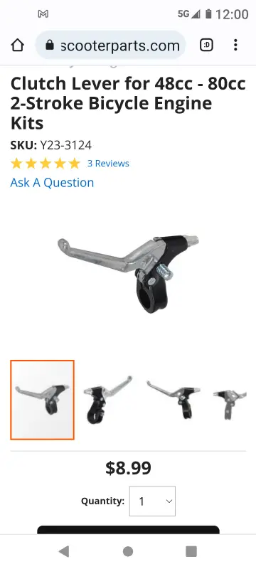

Those kind of clutch levers are total junk and either won't allow the clutch to completely disengage or you have to hold it in to get it there... The type with the locking button is going to open up the clutch more and keep it there and work like it should...
