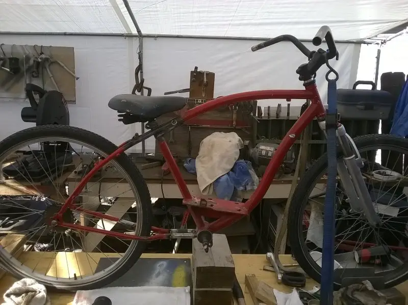

Since losing my my tried and true Electra, I've had to rob parts to finish the Silver bike. Sooo, I've put the bike I robbed from on the table and began again.

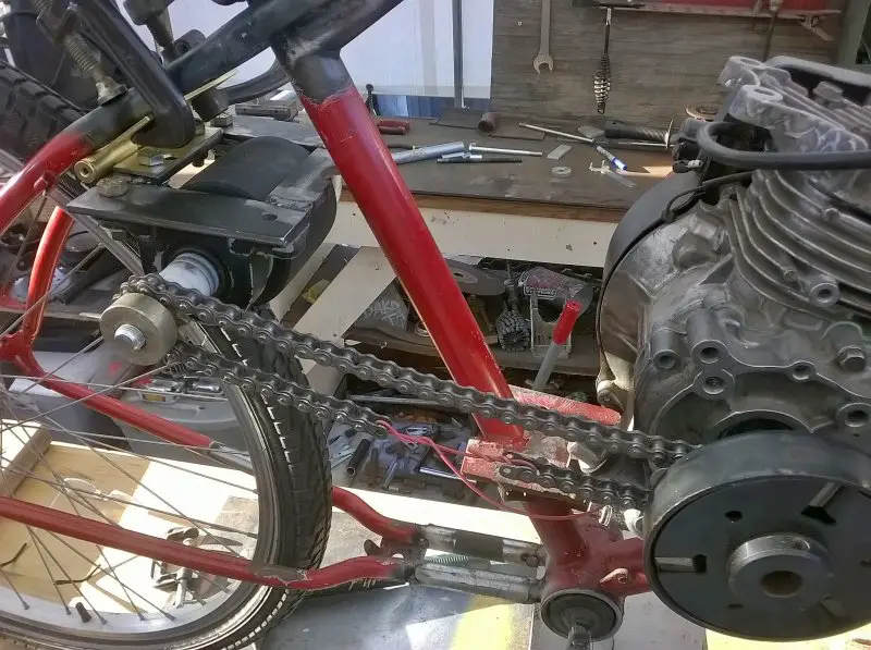

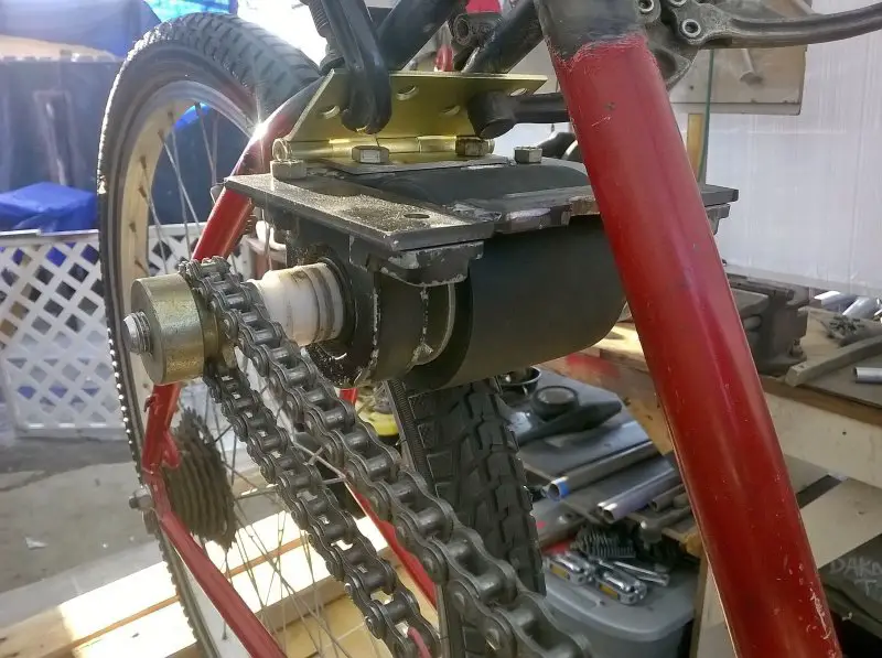

Well, this is my second try at FD. Eye think this might work. The hinge will not. To much wiggle. I'd like to take the 3" roller and have a curve put in to grip the tire more. The setup requires the roller to be compressed with the bolt & nut to cinch it. And when that is done it creates a ( ) that. It no longer is flat.

Well, this is my second try at FD. Eye think this might work. The hinge will not. To much wiggle. I'd like to take the 3" roller and have a curve put in to grip the tire more. The setup requires the roller to be compressed with the bolt & nut to cinch it. And when that is done it creates a ( ) that. It no longer is flat. View attachment 97107 View attachment 97107 View attachment 97108 View attachment 97108 View attachment 97108 [/QUOT. I'll learn to touch once when loading pics.....

I wonder how much a problem there is with slipping at all with friction drive? Hey maybe a metal part shaped to the curve of the tire for Metal/Rubber contact friction. Then it spins on a hinge spring loaded or bolted on with some degree of pressure?
The rubber roller works great. I've just got get a 12 or 14 tooth. I got a 16 and winds out to quick. It's on the back burner. Shifters are the way to go.
