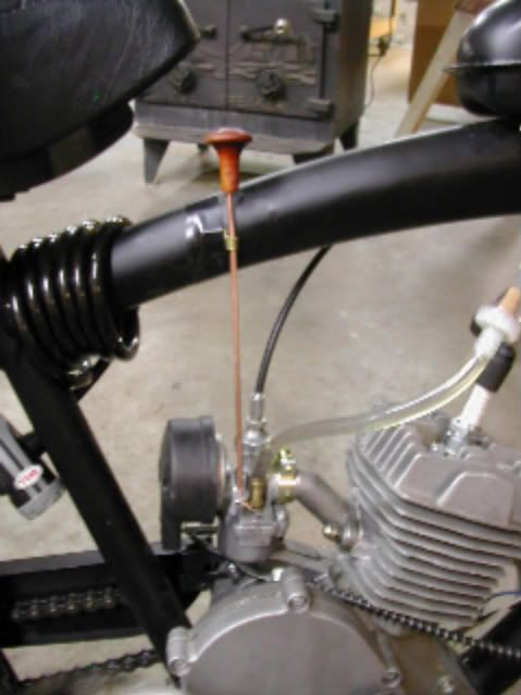

Well this isn't handlebar mounted,but it sure beats groping around for the choke lever.Ron
Re: Controlling the choke from the handlebar
Here's how I went about it.I used a 1/8" copper rod I had laying around , beat a flat on one end and drilled a 1/16" hole through it.Used a dremmel to cut a slot in the top tab of the choke lever(long enough to allow full travel). Pinned end of rod between the two choke lever tabs with a piece of wire.Took a thin strip of metal bent in half to form a sleeve and taped to seat tube.Sawed off Shaker peg for handle.
Not the most eloquent solution but sufficiently goofy enough to have a certain appeal.Ron
