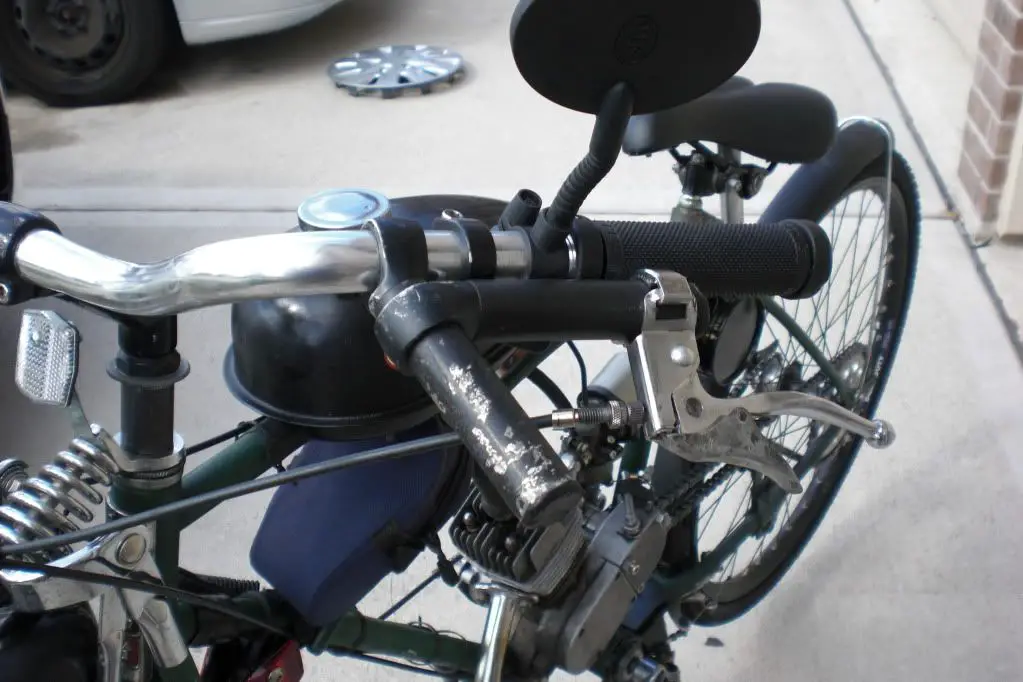

I never could keep my China girl clutch adjusted properly. I may have gotten a bad one or maybe I damaged it through bad adjustments when I was a newbie. I needed more pull distance in my clutch lever. I found a couple of mountain bike bar ends in my garage and arranged them to form a sort of accessory bar. My stock clutch lever now pulls a good bit more cable. I will be sawing off the extra length of bar end and plugging it.
