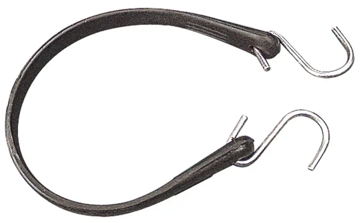

I don't know what experiences you guys have had, but I must disagree with this negative stance on using rubber padding on the mounts.
I've used some rubber from home depot bungee belts, and months later they're still there and work just fine. The engine has stayed in place and I've never had to re-tighten the mounts or change the rubber once.
EDIT: This is what I used:
Just cut off pieces or slice them in half to the size/thickness you need, and they work great.

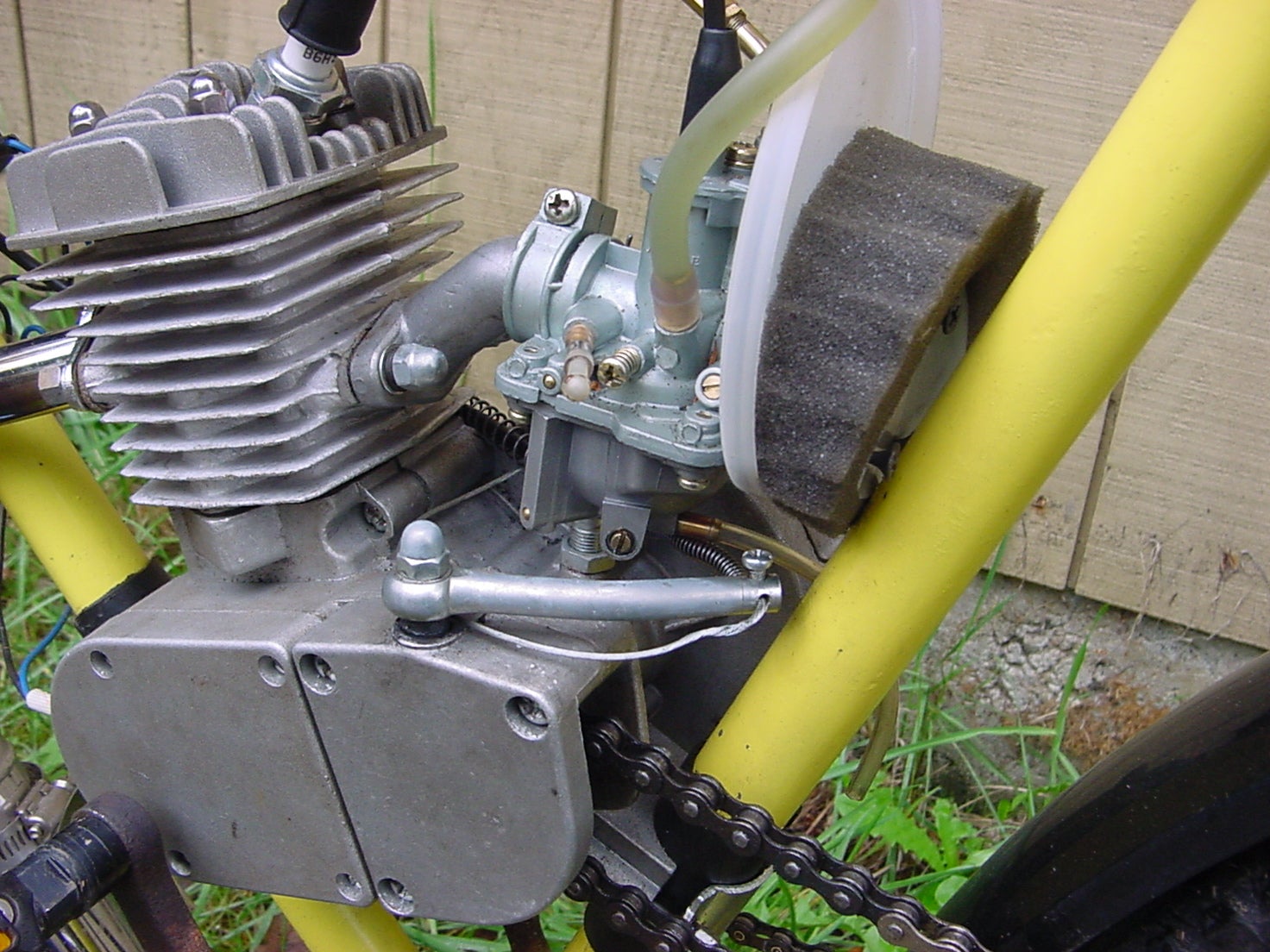

yeah dropped $20 on those p.o.s. and should have left a good thing alone...i was thinking they would lift motor a lil higher so my fancy pants air filter wouldn't rub...bunch of broccoli..didn't pan out. i'm not saying i'm getting frustrated..but i guess i am. all the lil extra things you think would be cool...end up being a headache to install
no sweat where there's a will there's a way :)
