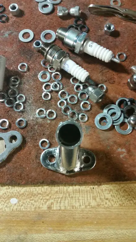

King motor bike sent me this crap I had to file and clean just so the bolts would snug down in a straight and flush fashion

I've gotten in habit of just throwing away the flat washers - the lock washers work even better on those lumpy surfaces : )
