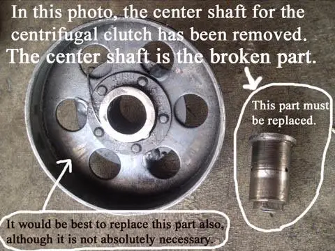

What is that spring thing that connect the bearing housing to the bell?
I'm talking about that piece of wire you can see going through one of the holes in the bell.
I have lost mine. Is it important? From what I can tell, it really doesn't do much except hold the housing in place when the clutch has been taken apart.
