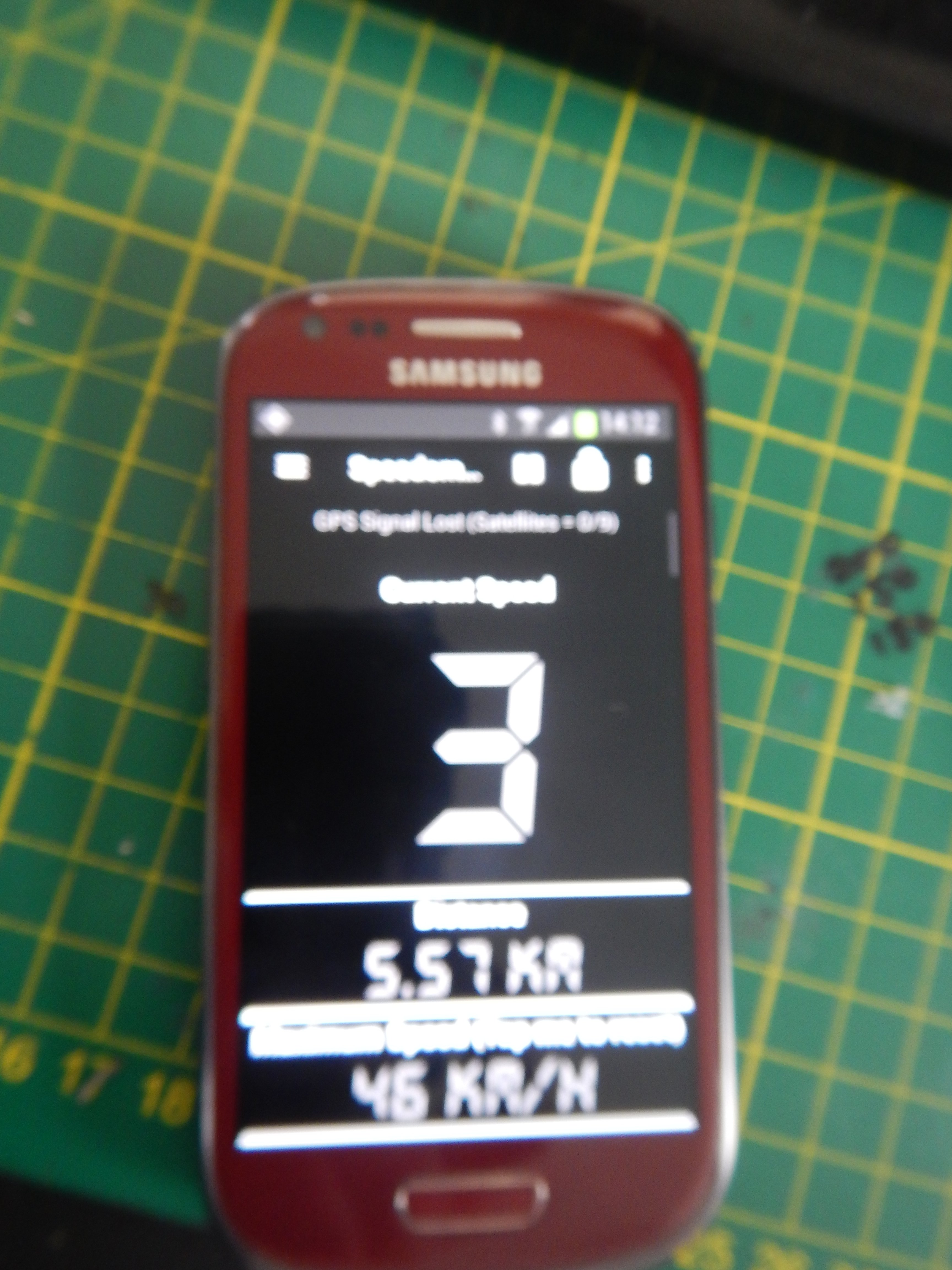

I Replaced stock items with Runtong (RACING CARBURETOR 2 STROKE MOTORIZED PUSH BIKE 49/66/70/80cc Engine KIT AU).
So; My first run, I have to say I was not impressed at all. Mid to full throttle doesn't exist. The engine peeks at half throttle and after that all you get is a muffled change in engine noise and no power increase.

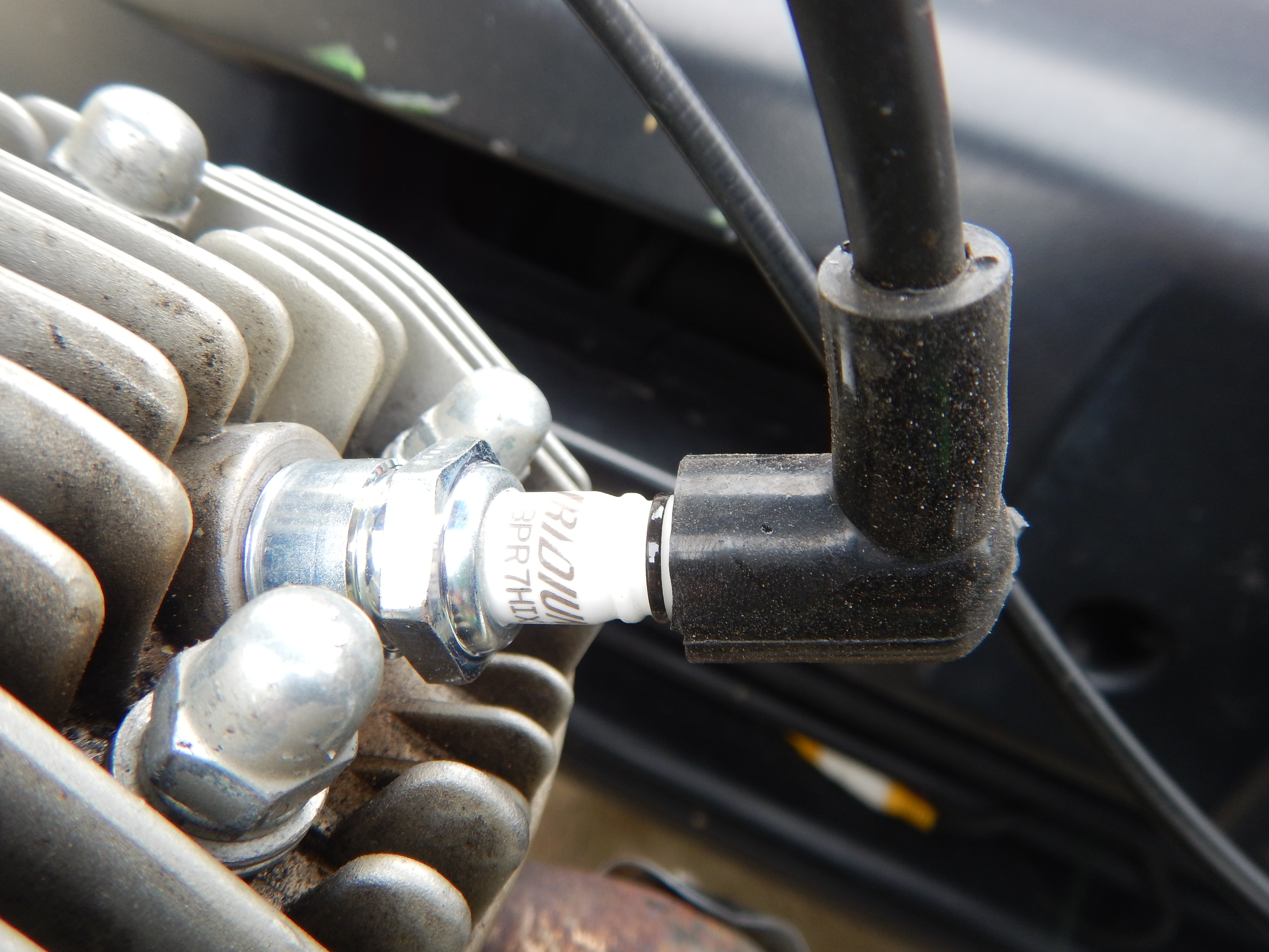

I then replaced the Runtong jet (I'm Guessing 0.70mm) with the stock (I'm Guessing 0.6-0.65mm) jet. Basically the stock jet has a smaller hole. My Iridium spark plug arrived; NGK - Iridium IX Spark Plug (BPR7HIX) so I also put that in. I now have a full range in the throttle. I have Significantly more power. I clocked my speed at 45 km/h and also notice better response to hills.
Summary; In case anyone wants to know. If you put one of these kits on, you will probably need to change the jet to the stock jet depending on your motor size. The new plug works a treat and as other people have mentioned the stock one is crap. I now have no fuel leaks and in general better designed carburettor that doesn't fall off while riding. My stock cable fit, all I had to do was change the adjustment pipe over from the stock carburettor. Was it all worth it for the power increase; Only just, the biggest thing I noticed was that it maintained speed better going uphill and ran slightly smoother. 46 km/h is fast enough for me. Cheers
