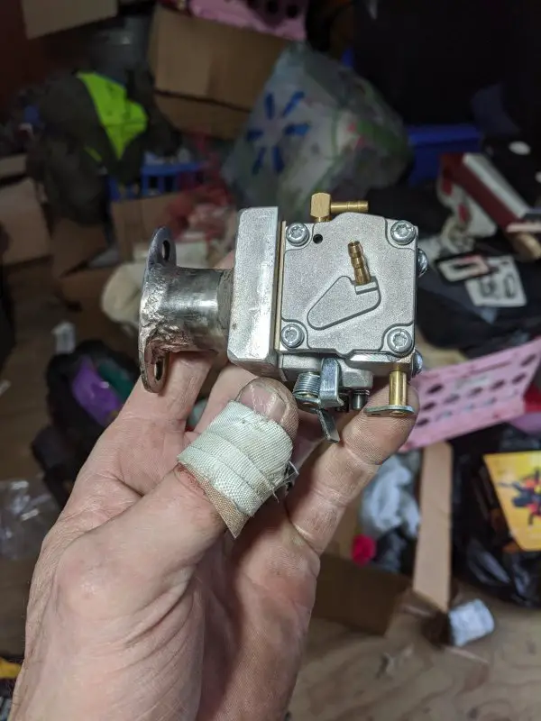

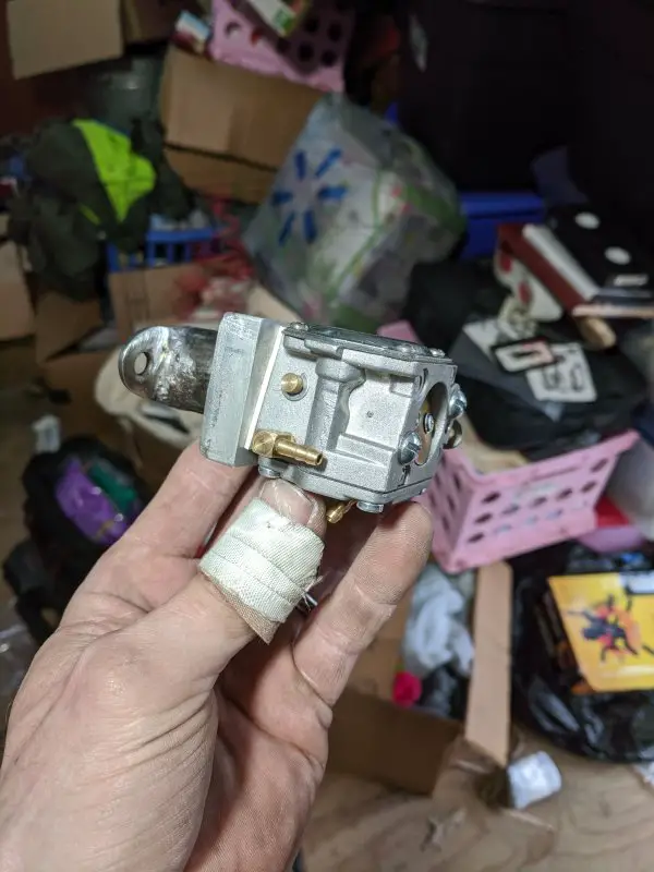

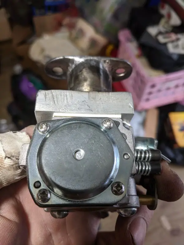

Just finished up this carb setup to be installed like cannonball 2

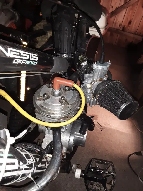

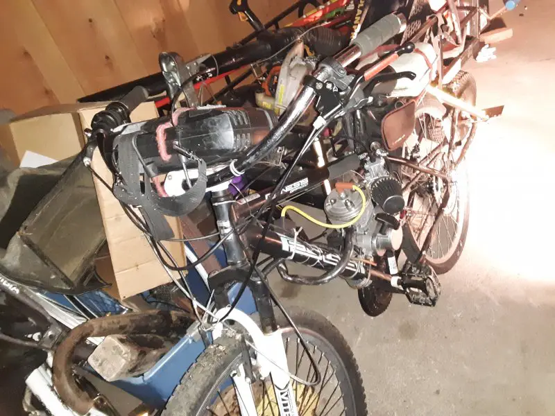

Today should be interesting, I've bought another 21mm pwk and I've installed it on the rebuild gt6 work bike, looks pretty sick and I haven't fired it up yet its 530 in the morning and I'm waiting for sunrise to finish up on the fuel line and tuning the carb ,took about 3months to figure out how to tune the carb correctly details so far running a #41 pilot and a 115main jet rather start with a larger jet and adjust the neadle clip up lean it some it's large jet so its gonna run rich but the clip placement should compensate for that ,this set up blows the doors off them fake ass rungtong carbs and the the stock n.t. carbs ,I don't get how some swear them rungtong carbs are the **** but ,their non adjustable only the main jet is interchangeable it's garbage hands down, if this carb performs as good as the other one I'll be WINNING, come on daylight I'll post pictures in a few

Check this out the bike runs great with the pwk dosent bog and I have full throttle response looks clean and fits perfect
