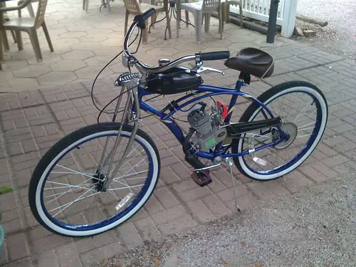

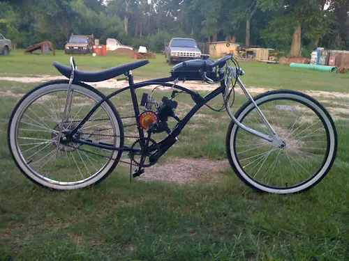

I have done a few huffy bikes with springer forks and never had that problem. I used a SUN springer fork in the first picture and the lowrider style fork in the scecond pic is from streetlowrider.
a local bike shop can get the sun forks for about $50 and its good quality.

Don't know enough about Huffys to comment, but did want to say the two bikes in the photos are nice looking builds.

the blue bike is just soooo naked cool lookin!....i cant wait to "spring" mine!

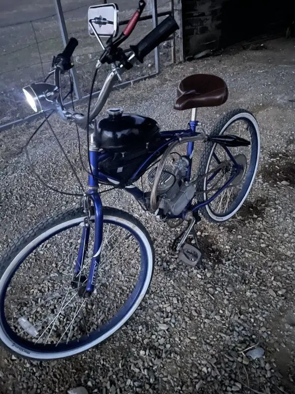

Came across this old thread thought I would add my bike. I have a cranbrook just like the one pictured

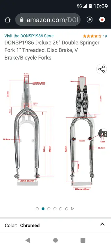

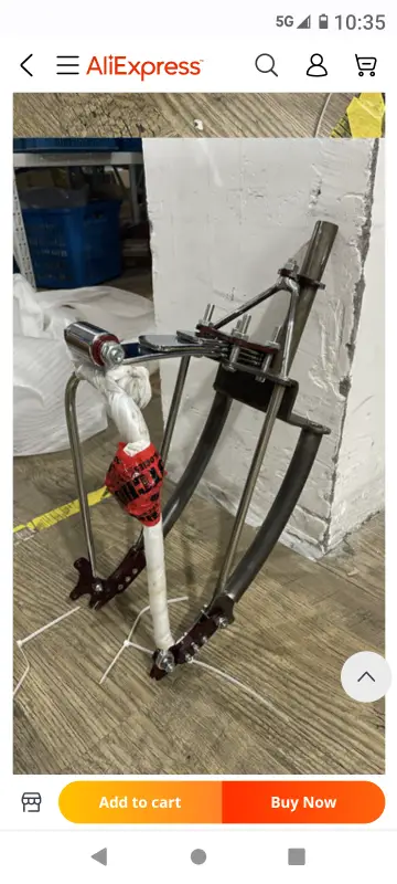

A fork I came across that's in stock I'll be getting it's for a 4" fat tire so it will get modified for a 2.125 that's if it's still available next week...

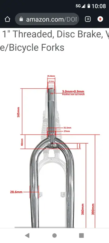

Every spring fork is going to fit the short steer tube of a huffy 160mm ? Most are 180mm Schwinn can be 220+ mm just get the common 180 length and cut the extra off... This don86 dude has the strongest one I've found in 165mm would be perfect for the Cranbrook... Chrome or black for the same money as the bike was...
