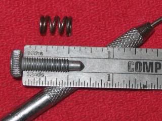

Do you know what size screw the carb idle screw is? Mine was backed out pretty far on the ride home and...gone. Now I'm running but she dies with every clutch engagement. Can you or anyone help? I have a Fastenal down the street so I bet I can fix it today if I can figure the size out! Thanks for all the help everyone! Chips
metric threads 4m dia. 0.7 threads
hope this will help
Norman
