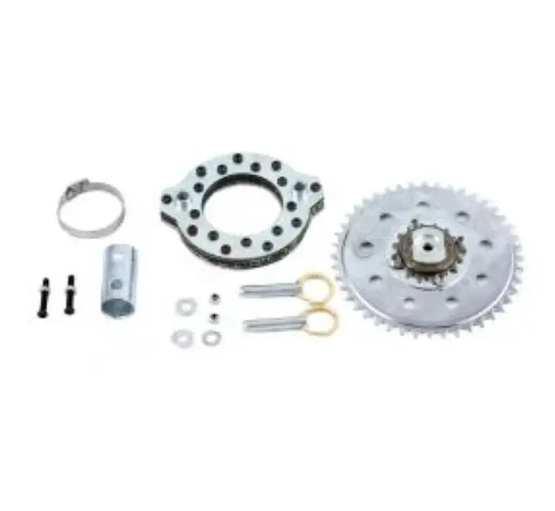

Prince, to switch from engine power to pedal power and ditch the huge chain drag install one of these free wheeling sprockets. I have one on my Cruiser and I find it works great.

Hi there, could you please link that to where I could purchase one or look into it? Thanks!

I found the item: https://www.motorizedbicycle.ca/hybriped-hybrid-pedal-sprocket.html
It seems kind of meh...you have to insert and reinsert pins everytime you want to use pedal power, because of the bidriectional freewheel. Any idea where to get a unidirectional freewheel system?

Prince, no sorry, I have not seen anything like that. In the beginning I mused about having the pins that could be inserted remotely though a solenoid and slip ring arrangement but after I started to get some experience manual insertion and extraction proved to be not much of an issue; requiring only a second or two to dismount and push them in or pull them out. Now I have so much confidence that I only use one pin.

Prince, I am not sure that I would agree that they are over hyped, They are the best solution that I have tried so far. Come to think of it, I do have a system for single free wheeling of the engine drive chain that I am working on but to date have not mounted it on a bike.
I have had bent spokes from drive chain jumping off the big rear 44 T sprocket and wedging down between the sprocket and the spokes. My experience with hub adapters was not that good either. I found that they slip on the hub and the through bolts ended up bearing up against the spokes which I thought was not a good idea. There are so many attachment bolts with the Hybrid Pedal Sprocket that the spokes are safe from bending. Top speed is not an issue with me because I am too much of a chicken to ride any faster than 20 mph on my bicycle.

I am not an expert in this field but I think, if you are lucky enough to find a hub adapter that fits your hub perfectly and can be tightened down enough to transmit the driving torque through friction without slipping I would say go with it.
