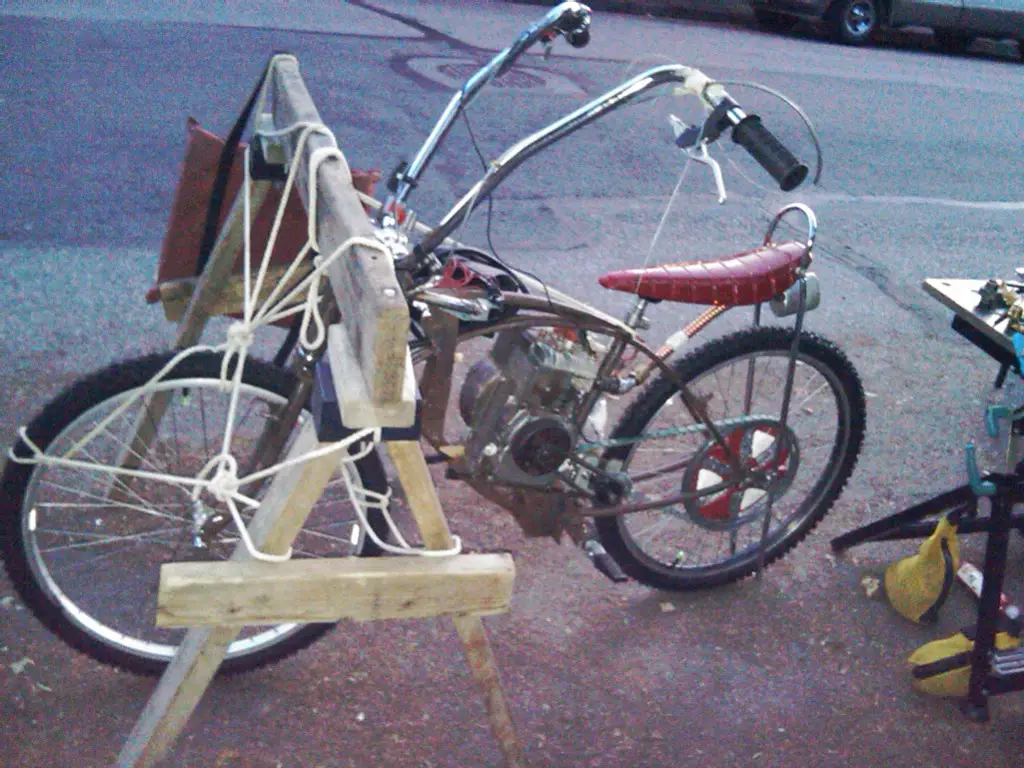

Removed the governor yesterday. Mounted my engine today. Had gotten a universal mount. What junk!!! I won't even take a pic cause I'm embarrassed!!!! I'm getting 1/8 x 4 flat stock Monday so I can make one. I knew i should have made one but I convinced myself it be ok to order the universal mount.
Made a mount, mounted the engine, it is solid but I'm still debating a gusset from the headset to the motor.

The above picture links is a while back before a lot changed on my bike, except that the gussets welded are the same.
I put gusset shims of sort under the motor mount plate to even out weight stress. Also weld metal plate on the frame top tube to mid (where I have those) an to bottom tube in front of engine (not connected to engine though) to spread stresses in frame out.
My engine is 1/2 the hp of that 212 and checking with others that have had issues using a 212 to see what is best.
Recently I saw posted where using the other mounting points on the engine of the 212 had caused engine to crack the case. I suspect the base engine bolts have a better strength but the ones otherwise that are there for the gas tank seemed to be a down fall.
