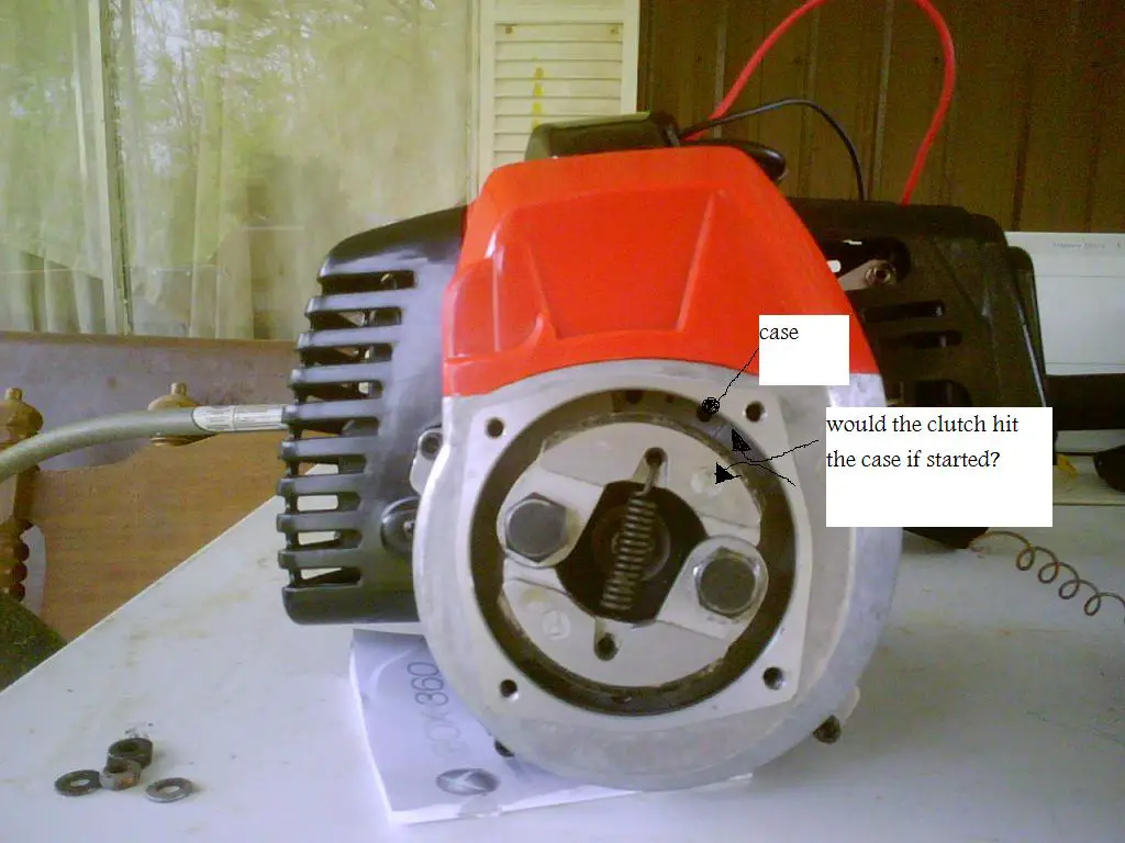

i was wondering if i could start this motor without it being attached to the kit, would the centripetal clutch hit the engine housing, i want to know because i want to test the motor before i put it on my bike, ive attached pictures to show what i mean

You can start it and run it but keep the rpms low. Do not run it at high rpms. The clutch relys on the outer drum to contain the weights. If you decide to try it, wear a good pair of safety galsses. This advice comes from experience.
