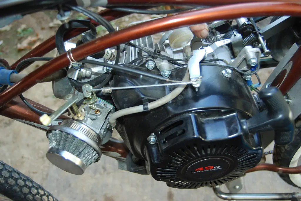

Here ya go. I removed the stock throttle assembly and added a spring pulling the bellcrank towards the pto side of the engine. My finger is on the spring in the pic. I safteywired the end of the throttle cable thru one of the holes in the bellcrank next to the throttle rod. Then I wire clamped the housing to the bike frame as depicted.
