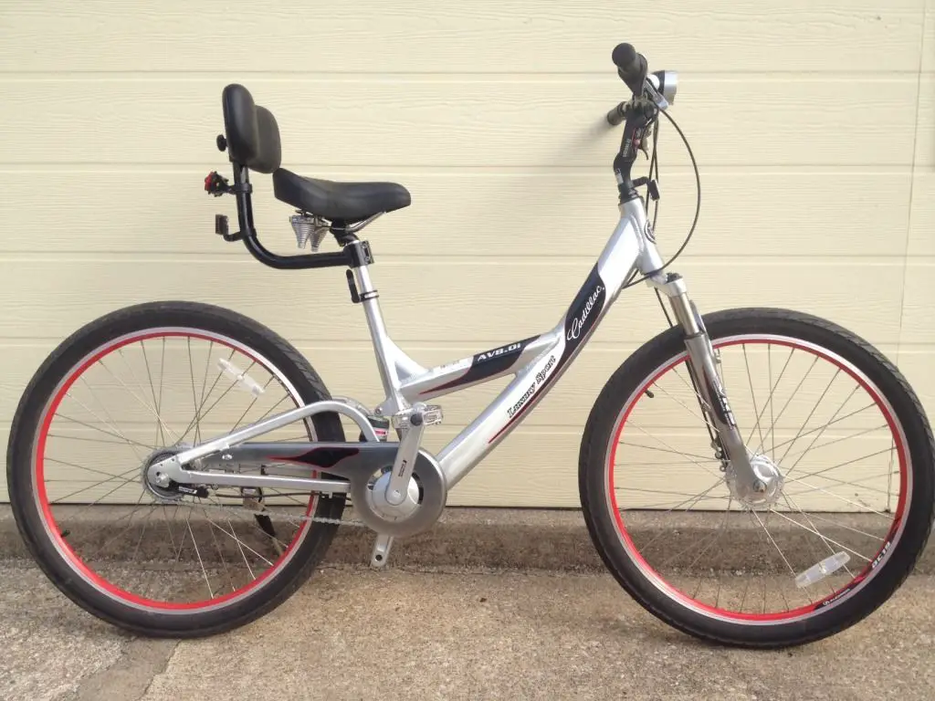

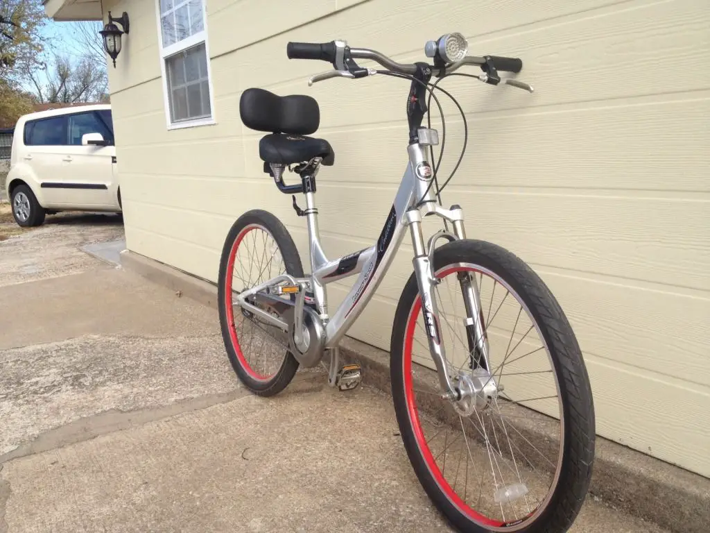

Has anybody try to put a motor on one of this??
If so, pics? if not, ideas?
I wanna go with the Honda friction kit, the problem is that this is a full suspenssion bike and i need to do some "engineering"
It is an 8 speed with drum brakes, all in the hubs, no idea how it works but it does!!
I found it at a pawn shop, i liked it because its weird, but it does ride like a cadillac, never seen one before!
I would do a rear mount 4 stroke, the frame should handle it. Don't leave the ground till you see what the frame is going to do wear wise. Welcome : I get caught up in bikes more than people, (c)
I was thinking about the Honda gx35, i have it on my Giant and it does very well, i took my first 50 mile trip today, enjoyed every minute of it
I seen Cadillac and it caught my eye, I haven't seen that model either but I built some Cadillac Fleetwoods like this.
That looks like a Strumey Archer internal 8-speed, it would be shame to not let your motor use it, especially having front and rear drum brakes.
If I had that bike I'd strip everything off it and put it on a Grubee motorized bike frame with the built in tank, then put a 4-stroke jackshafted V mount kit on it.

They should be and you have some nice parts on that frame, a good $350+ worth with those wheels, front shock forks and nice seat even used.
That Grubee frame has 1-piece BB (Bottom Bracket, AKA pedal assembly) holes but if you go Jackshaft that is a moot point as the shift kit includes all that with one exception, you will need the 1-piece to 3-piece BB conversion cups (~$12.).
There are 2 types of frames, one has a perfect front mount frame post, the other is for 4-stroke motors.
A 2-stroke JS kit fits the same as a regular front mount so great there.
Just buy a dual pull brake lever and Iridium plug if you go 2-stroke shift kit for SBP.
NOTE! Shift kits are are NOT easy to install but with that perfectly design bike frame it will be a whole lot easier and with a 2stroke, even a legal (here) 48cc that thing should fly.
