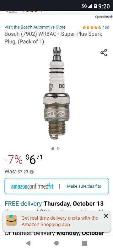

The Bosh 8 is a ngk 5 (00ps) heat range ... 7/6 because they get hotter the higher the number and ngk get hotter the lower the #... I have some Russian made super plugs with the blue rings I might have a green Germany one for a car show or something dub
The Bosh 8 is a ngk 6 heat range ... 7/7 a Bosh 9 is ngk 5 because they get hotter the higher the number and ngk get hotter the lower the #... I have some Russian made super plugs with the blue rings I might have a green Germany one for a car show or something dub
Actually... Bosch #W8AC is equal to a NGK #B5HS
I know this because either of these are the correct plug for my VW bus... (old VWs like hot plugs) :)

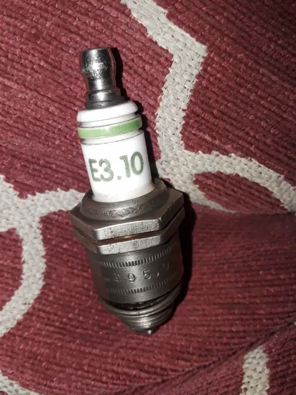

I just found a new spark plug it's an e 3.10 it's kind of short but it's got a dual Stinger on it.
I'll try the Gap test on it also.

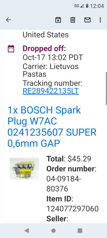

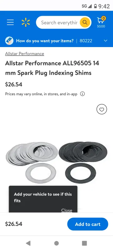

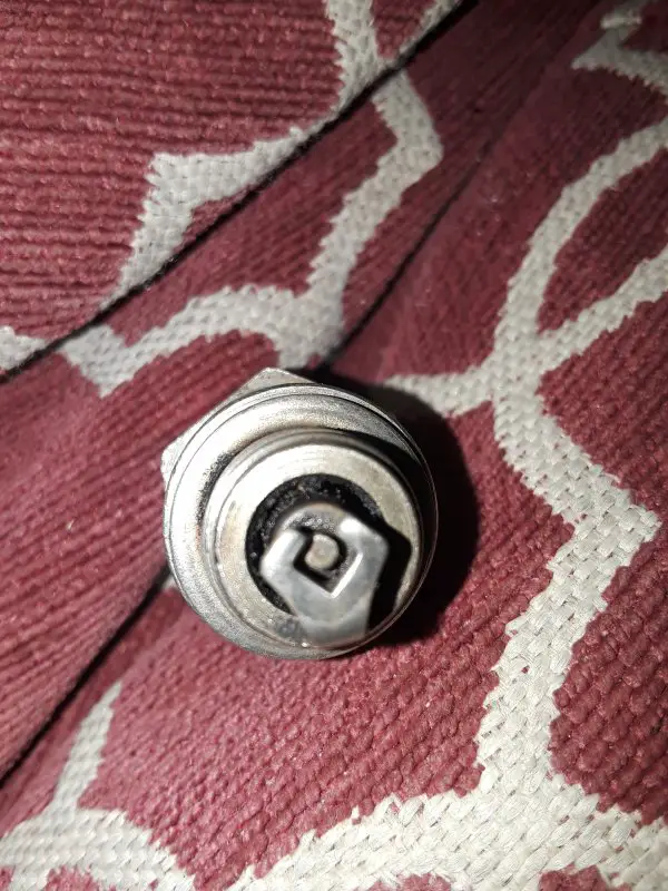

Thank you Wevil because of this thread I learned more about plugs and I'm going to try the E3 1.0 plugs... And I also found a deal on some WR7AC Bosch to stock up on... Sometimes it makes a difference how the ground strap on the plug is positioned in relationship to the exaust port... Where it points to when tightened down... How it's made and it can vary from batch to batch for the same # kinda luck of the draw... Also the heads can vary how there threaded and there are different thickness shims available to clock the plugs... So I try to get a bunch of plugs and try and keep track of which ones end up where on whatever... Every little bit helps... Thanks for sharing some love after all these are dangerous machines that are a fun for us to create... I don't have to even know you to love and respect that we're all brothers in this game together... ' It ain't the size of the motor but the size of the heart of the rider that matters...
