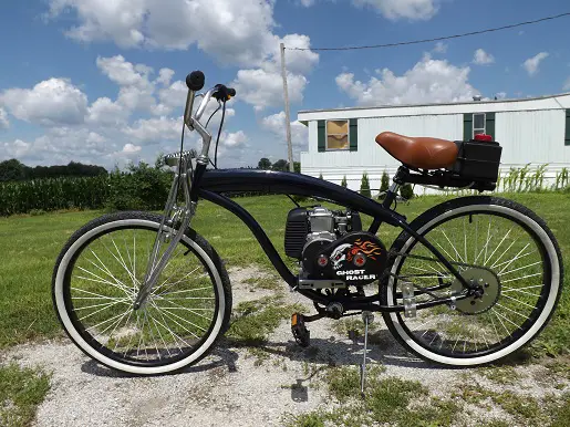

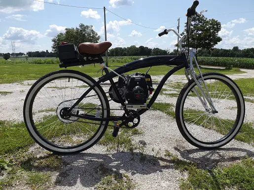

IT'S ALIVE!
Sorry it took me so long to build it. But last Summer I got into playing golf and just kind of lost interest in Motorized Bicycles for awhile. I spent all my bicycle building money on golf equipment. But I finally decided to dig it out of the barn and finish it.
