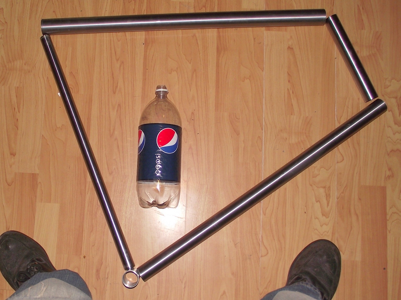

I gots test tubes! Huge diameter monster truck roll cage tubes! The 42mm top tube is massive! Put some fins and a nose cone on it and you could fire it out of a bazooka. LMAO
Plenty of headroom for the GC160 and a tunnel tank laying over the top tube. The Felt Slater/MP frame is nearly a perfect motorized bicycle
frame, but now it's my turn to add a few modifications to that design.
I'm just gonna make the triangle a bit taller actually. Nothing radical.

Plus I have to deal with the pedal side chain, which no motorcycle has to take into account. Without a jackshaft, I'm going to have to deal with chains running at different angles on both sides of the bike. No biggy. I'll figure it out somehow. LOL
