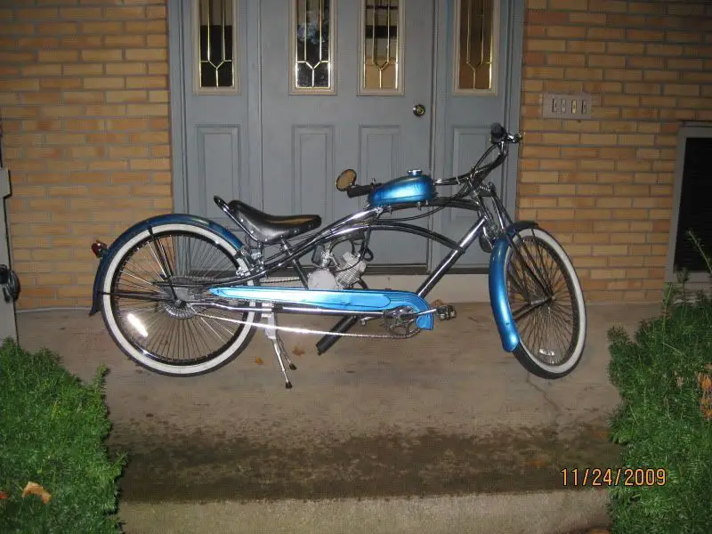

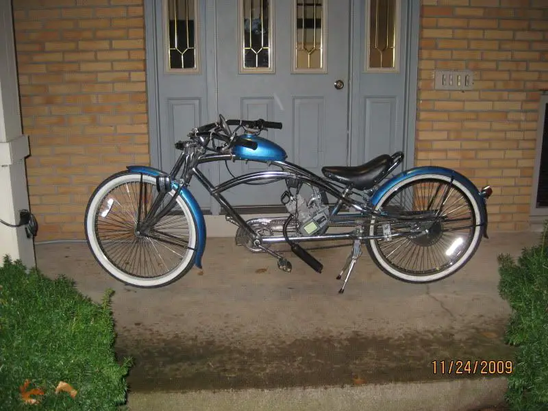

best looking micargi I've seen! love the dualing chain guards and non interference with stock pedal chain. did you replace all the bearings and oem stuff?

how did you mount the engine?
I mounted my engine toward the front of the frame instead of the rear. The only thing that had to be longer was the chain and chain guard. Does have quite a bit of chain noise but runs really nice.

beautiful bike!! hows the center of balance with all the weight up front?

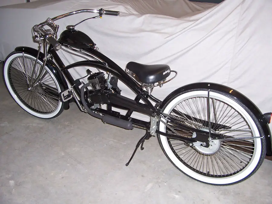

Wild to read your early questions in the threads, and then see the finished bike. Beautiful job Cruzin, truly an awesome bike. I hope that mine turns out as cool. I am doing a rear mounted style(seatpost) because during the 2 years I've ridden it around town, the nature of its length and front heavy frame is to fall over off the kick stand, or generally be a pain to park., and unable to ride hands free. So I'm wondering if the riding characteristics will be better or worse... i'd love to hear from someone who hasa ridden both mounting style versions.

Hi, did you have a problem with the drive chain rubbing against your sidewall of the read tire ? Maybe mine isn't aligned correctly.
Not very good! It`s very front heavy,hard to steer and hard to park on its kickstand.
The second one that i built is a rear mounted engine and is the best handling and easiest bike to ride. i love it! Never do a front mount again!!!!
