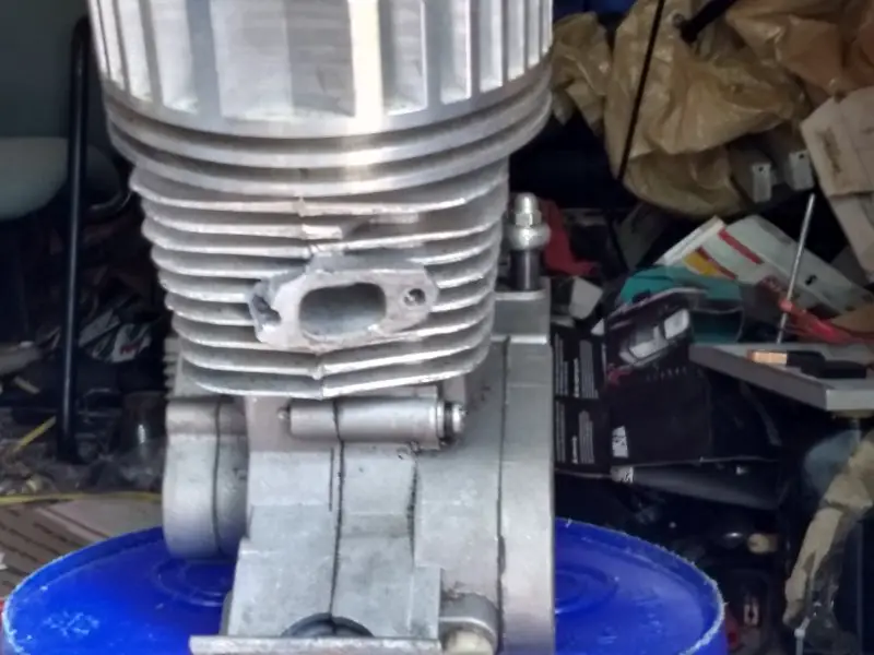

I was trying to attach a new log exhaust onto the block the outside of the bolt hole had broken off. Is there away to repair it? I do have a gt90 kit that I can use to make changes with.

Hello, you will probably not be able to fix that, you will probably need a new cylinder because the tab is pretty much broken completely off...a plain stock cylinder is about 25 bucks ... Make sure you get the right cylinder for your engine or it might not fit the stroke and hit the bottom off the head or not go up as much as needed and lose compression plus the ports need to be in a certain spot... Hope this has helped

I broke both sides on mine ..what i did is i super glued both back on for which its just to hold them in place so i can work on it ..i then took a wire coat hanger and cut a piece off of about 5 or 6 inches...i then twisted both ends so each side had a loop in it...then i wrapped it around while forming it to the little area on top of exhaust port until each end of hanger are down each side of cylinder about 1 1/2 to 2 inches snd then put a good steel bolt through the loops of hanger and tightened a nut down forcing the ends off hanger to tighten around the broken and glued pieces...i did it 2 days ago and its still all good... I wish I felt would have thought of that sooner come up with something that worked... Give it a try... Worked for me, don't see why it can't work for you...G.L.
