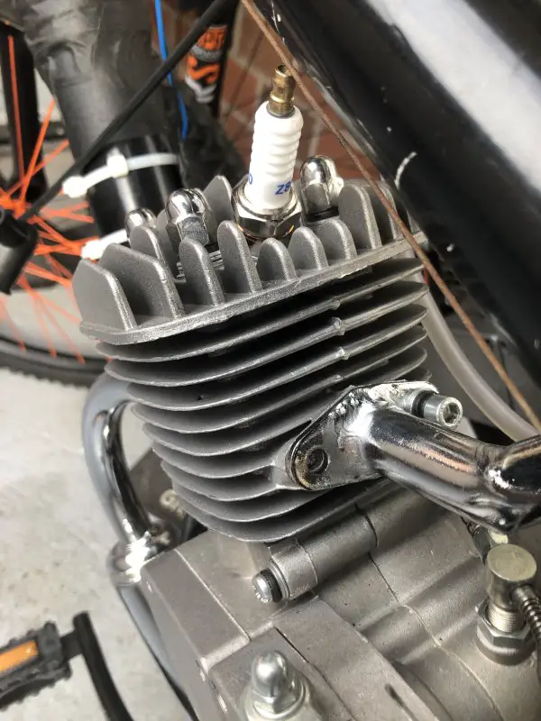

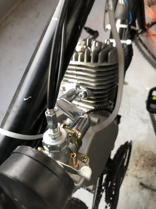

Nope. Without that bolt in there, you'll have an air leak, which will destroy your motor from excess heat, and from running lean. There is no easy fix.
That is the Intake mounting flange.Hey guys I broke my Chinagirls carb mounting screw. I tried extracting but the god damned extractor broke off and now I’m wondering can I just run the carb off the one remaining screw and hose clamp to the post to somewhat seal off the other end? Do I weld it to the engine or is there a sealant or something I can use. I’m using a carb offset on the setup.
