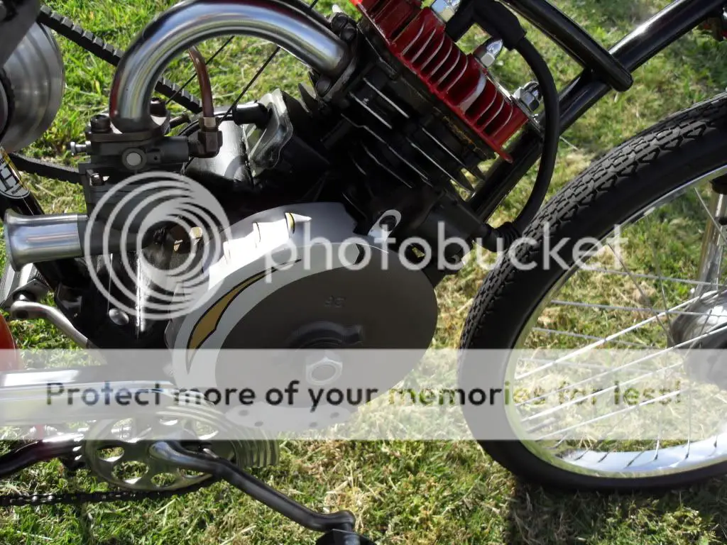

I have run three machines with no cooling shroud and modified flywheels and have had no trouble with overheating, but having said that, I would be very nervous about removing too much of the cooling fins unless it was just rounding off the corners a bit. And the head?...I wouldn't touch at all...unless you were considering shaving the fins altogether and welding on some larger ones in the direction of air flow to help dissipate more heat...I was considering doing that with my current build, but just don't have the time.

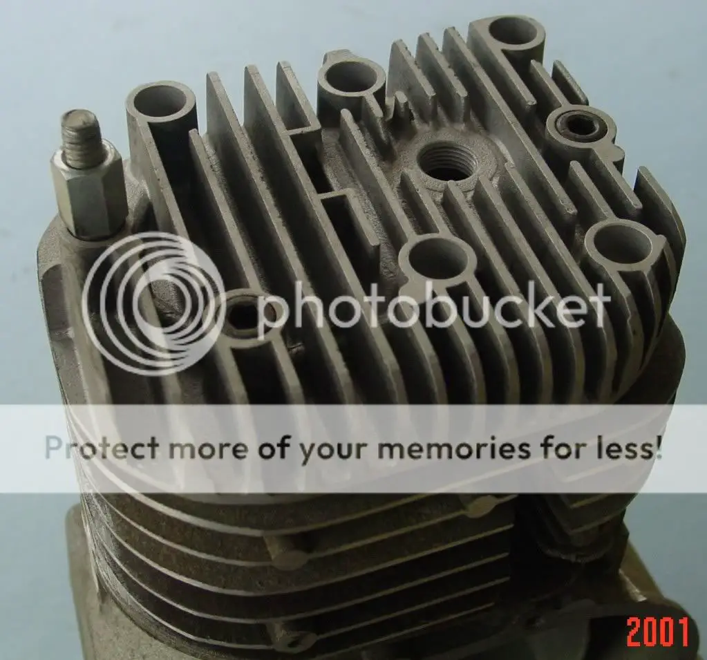

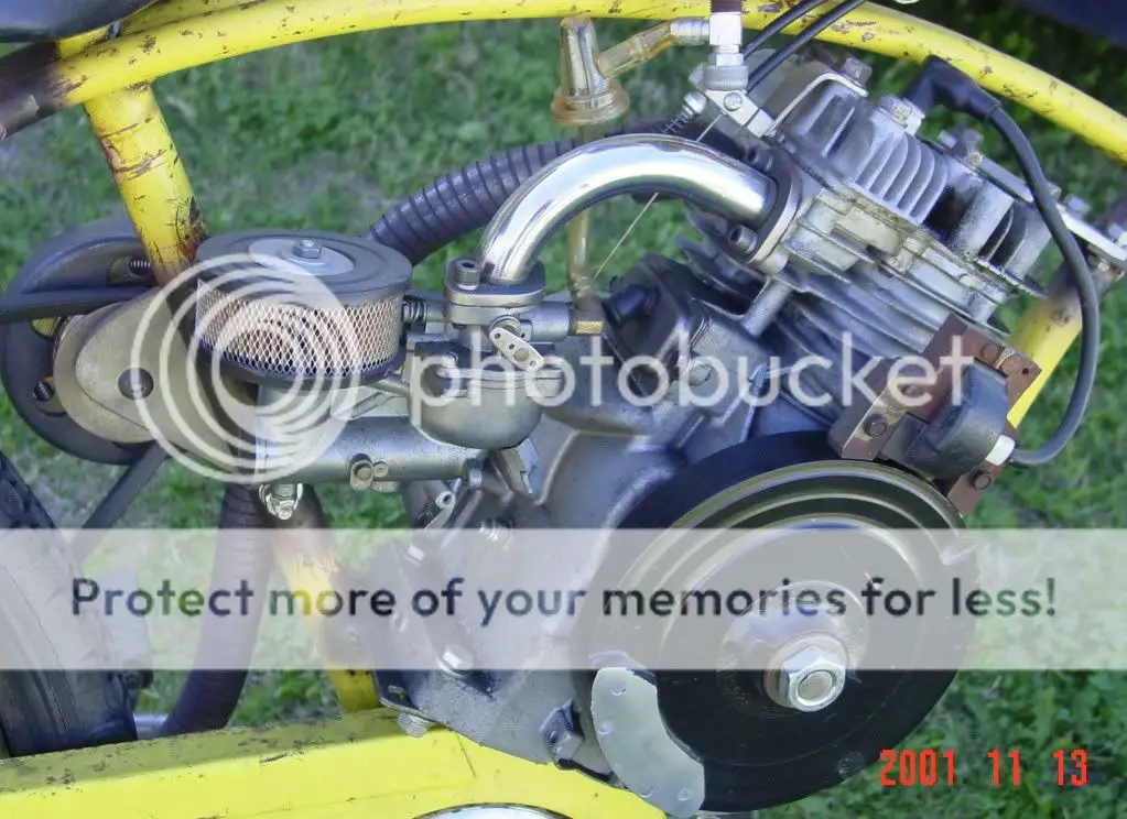

I've been running 5hp Briggs motors for over 20 years all trimmed up with no flywheel fins or shrouds. Cylinder and head cut down extensively with no overheating problem, ever. No reason you can't do the same. Trimming the cyl. and head give the motor a totally different look than the stock Briggs. Squared off, angled or rounded, you should have no problem. Would love to see what style you come up with.

What tool do you use to cut and trim the head and cylinder fins? Is it as simple as an angle grinder with a 4" grinding wheel?
Thanks for the pictures and tips. I have a 5hp B&S motor that I would like to trim down. Also, do you know of a source for those allen head topped head bolts for the briggs engine?

Hey Gilbert. I use a band saw or hack saw on the head and just a hacksaw, angle grinder/sander and files on the cylinder. I got the allen bolts at Mcfaddendale hardware, but you will have to countersink the towers on the head. I needed clearance for that project. I also use allen bolt lock washers to keep the bolt head off the aluminum.
