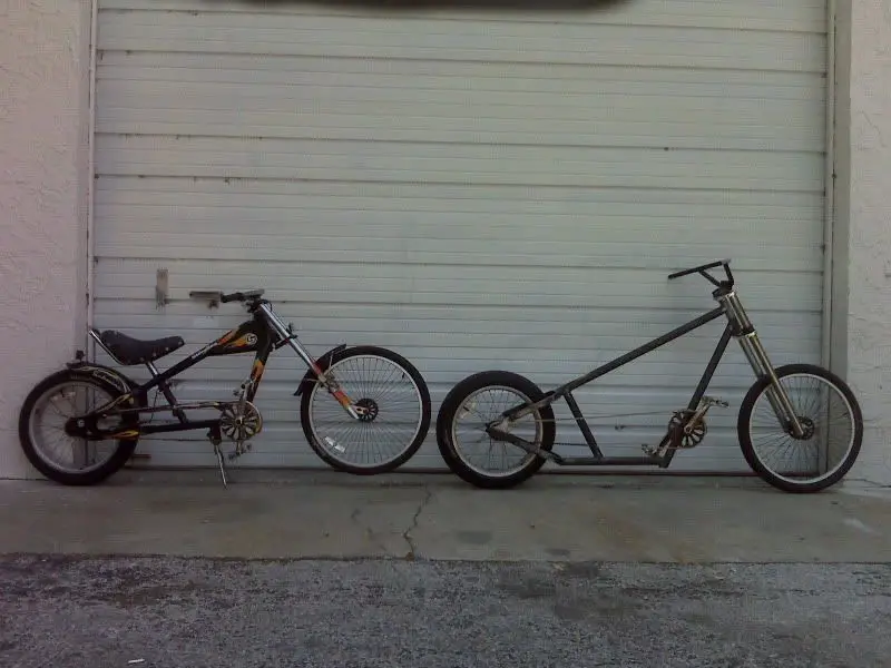

Another comparison shot to show the before and after.
Once I finish the spring loaded solo seat sliding clamp, you'll really be able to see the change in reach and stretch on my frame from the stock Stingray.
'BrettMavriK
Heheheh!
It looks as though it would hit, huh?
It doesn't on either; in fact it has 5.5" of ground clearance.
My Orange coast chopper with its' low slung flame shock bracket and centrally mounted exhaust, which were lower, never had a problem either. Many custom motorcycles have much less ground clearance than that,
and at that lowest point they can be 16-18" wide.
Btw, that little excess tubing hanging lower on the front down tube will end up flush. It is being used now for tack welding the frame to a stand on the table for steadying as I work.

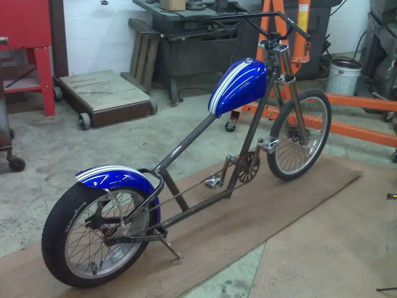

I got more work done today on the build.
The tubing clamps that will hold the isolated motor mounts, adjustable jackshaft, and adjustable mount for the spring loaded solo seat are all made up, and they are bomb-proof. Then I built a new rendition of isolated motor mounts using a different isolator but they failed the test, so I had to scrap em'. I going back to the drawing board on that aspect with what I originally used on my Orange Coast Chopper, only improved upon. They were tried and true, so I don't know why I decided to get fancy and waste time.
Grinch- "That's what these tests are for!"
So, I'll have the new set made up tomorrow and I can move onto the jackshaft and seat.
Not much after that but running cables, wiring, whitewalls, and paint. The bike is themed after a Shelby Cobra.
