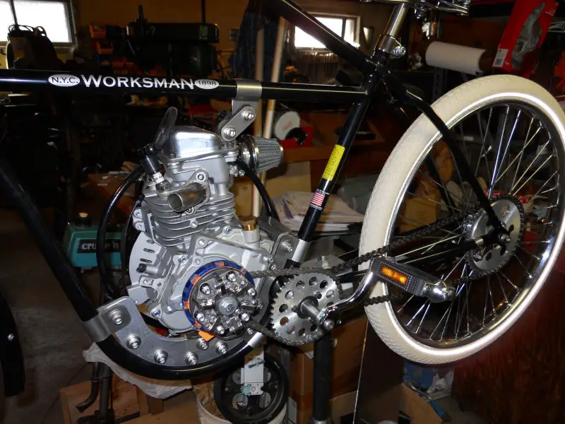

Having to disassemble a clutch every two hours running time is bogus. My Bully clutch just works. Bully clutches are about double the cost of a Hilliard. But you get what you paid for in performance. A look at my clutch.
