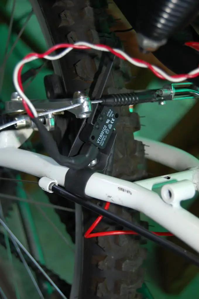

Here's a photo of how I mounted a micro-switch activated by the rear 'V' brakes.
There's a little arm on the cable that hits the button on the switch when I apply the brakes.

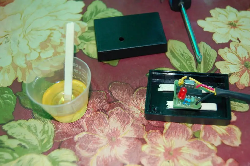

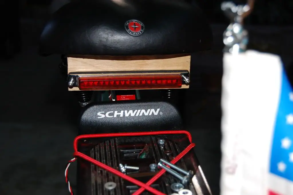

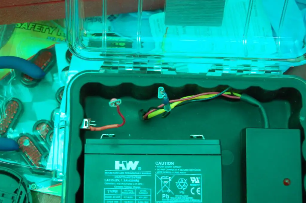

I used a snap action switch for my brake light switch. When I pull the brake handle, the switch is pressed by the brake assembly on the rear tire and the LED Bar I have becomes brighter and flashes due to the module I wired into it. When I release the brakes, the LED bar goes back to a running light. I used a Pelican case as a battery box and it is hooked to the side of my luggage rack as a "Saddle Bag". The battery I used is a 6v Gel that is charged with a solar panel during the day. The whole system has a "kill" switch attached to the side of the Pelican box.
I Plan to Have an Instructable up about building this system in the next couple days.
