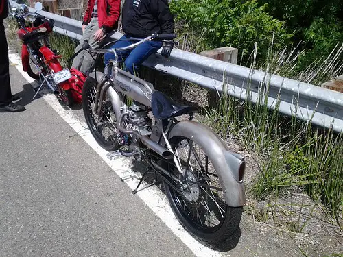

Spring Whizz-in 2013 by Sportsman Flyer, on Flickr

Dig that dampner,heres one
That's a sweet lookin' ride Truckd, you get credit for digging deep into the vaults for classic old pictures. The guys building those old bikes were leading the charge in innovative new ideas. Funny that we're looking 100 years into the past for 'old' ideas. Pat's 'new' dampener is a perfect example, sure his is cut on a laser, but it's old tech and works great.
