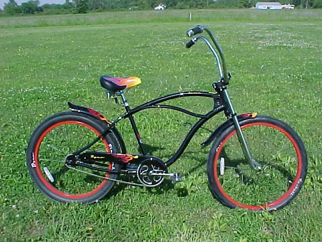

I Started out with a cruiser from GT (Dyno Deuce)
The pic is borrowed.
I started to strip the bike and rebuild it..
