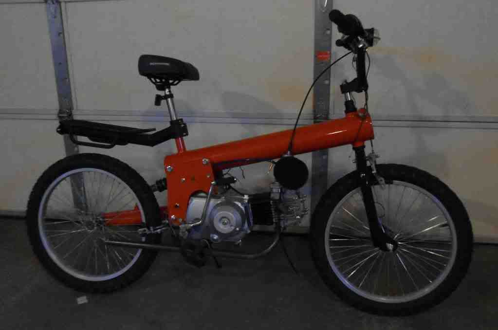

Please take a look at my ongoing prototype project.
I plan on adding a Sturmey Archer drum on the front, stronger rims and spokes.
For those that know, since weight isnt an issue.... what are the strongest 20 inch rims for a bike? Steel? Aluminum? AND anybody have a good resource for heavy duty spokes? Electric bike spokes?
I was thinking of giving it a good shakedown this summer and possibly making a batch of frames if there is an interest.
Opinions welcome.

That's a wild looking creation you've built
Can you give more details about what you've got going on there?
What kind of drive is that?
Does that rear wheel only get support from one side?
How about that frame? Did you build it from scratch?
It's cool but not gonna be street legal without pedals.
Can you put up some more detailed pics?

The engine is 90cc 4 speed auto clutch honda copy.
The swing arm is single sided.
Built from scratch except the forks.
Its street legal. Registered as a custom made motorcycle.
Cost...out of pocket? hard to say. Lot more time than money. So far.
Will go to Dans Comp.

Well not sure about elsewhere but in Illinois you'd have to register/plate it as a class L motorcycle and also get the class L endorsement on your drivers license. It would definitely have to be cheaper than a 100cc equivalent dirt bike to make it worth getting.
How sturdy is the frame? Have you put it through any torture testing yet?

Way strong for a 50cc. For a 90.... Time will tell. Im upgading the front brake, rims and spokes. Then...out for abeatin'.

That is one awesome design! Kudos to you for thinking outside the box. It could be done with a 49cc and pedals and be a legal motorbike.

Looks great, but it's going to beat you to death off-road with a rigid fork and 20" wheels.
If getting there is more important than getting somewhere fast, looks like you've got it made.

Bairdco Thanks. I will be getting 11 spokes.
Happycheapskate My plan is mostly trails and the street. I do have a set of shocked forks on the way (cheap set). There arent a lot of options for suspended forks that are semi affordable.
I just bought the Archer 36h brakes so 36h are the rims. I ordered a set of 2" wide tripple walled rims and some 2.25 wide tires.
Ibedayank 1" axle for now. The hub is only 2.5" wide so the side flexing will be minimal. (I had a Triumph 955i and an RSVT. Both had single sided. I like the simplicity and look) Im guessing the bike should be around 85 lbs. I have some engineer friends that will do the # crunching for strength. Im more of the creative type.

cool my trike uses 3/4 for the rear wheels and mounted only one side.
was just hoping you didnt use a regular bike axle. Nice job so far will be watching as you finish the build
