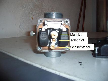

Hello. Got the bikeberry hp carb and it runs too rich. Can someone tell me where to get Jets for this? It says " runtong" on the side. Thanks
I was told by bikeberry After I bought my kit with the HP carb that it has a fixed jet so it won't work in high altitudes.... Which I am in. So I just ordered an NT. Are you saying you really can jet this hp carb?
Certainly you can replace the jet size in an HT carb, BikeBerry if full of crap if they told you that. Both the NT and the HT carbs take the same jets, 5mm, here-----> https://www.ebay.com/itm/5-JETS-Low...133936?hash=item3f45737430:g:70cAAOSwkQZbWOgr
and here---> https://www.ebay.com/itm/15-Jets-5m...223069?hash=item46816ea61d:g:84QAAOSwGzxZf8Eo
Well hm.. I wouldn't be surprised if they were full of crap. I'm starting to realize how they are like that. I'll have to take apart the HP carb and see for myself... You know I'm talking about the "HP carb" right? Here's the link to it, and if you read the description it states that it does not work in high altitudes because it has a fixed jet needle. Oh and thank you for your reply and advice.
https://www.bikeberry.com/66-80cc-high-performance-carburetor.html
