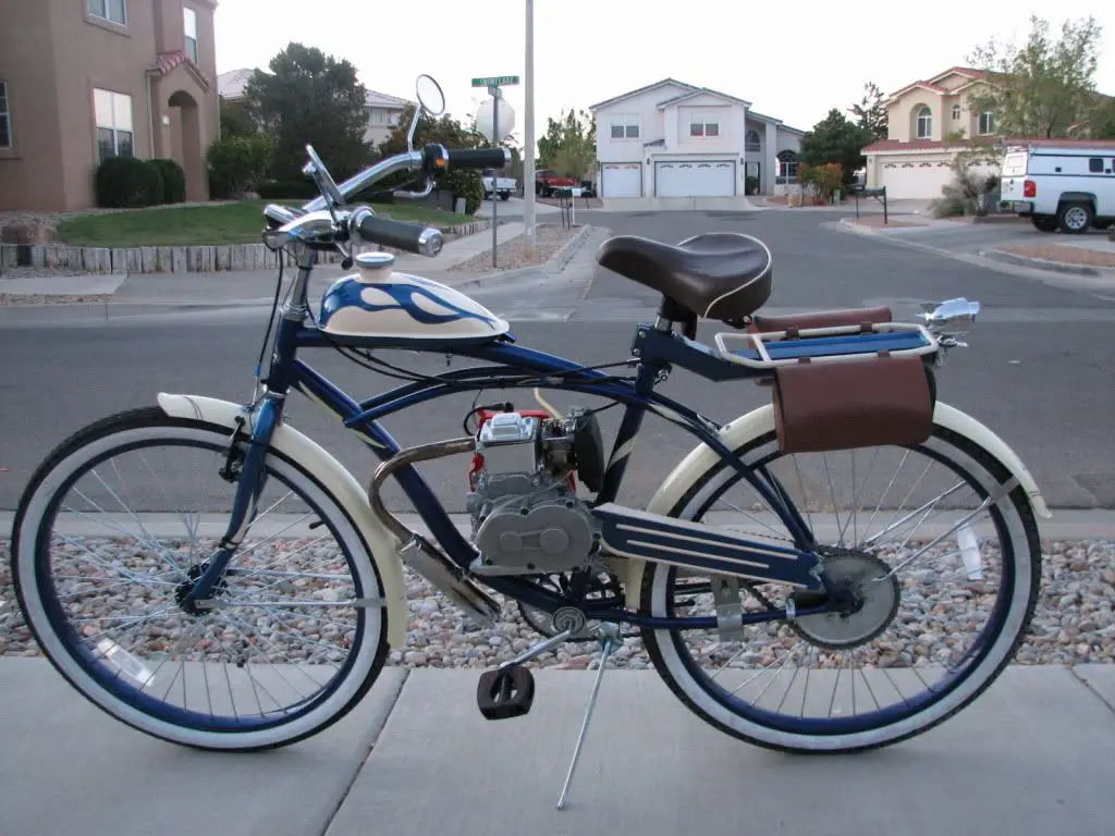

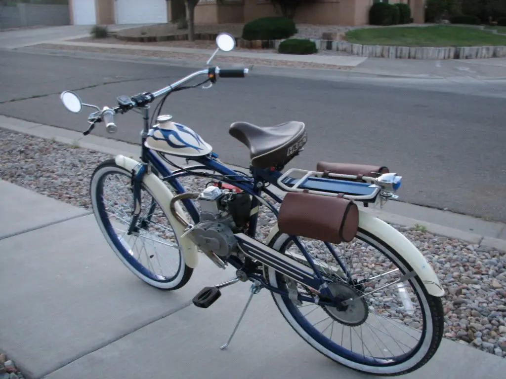

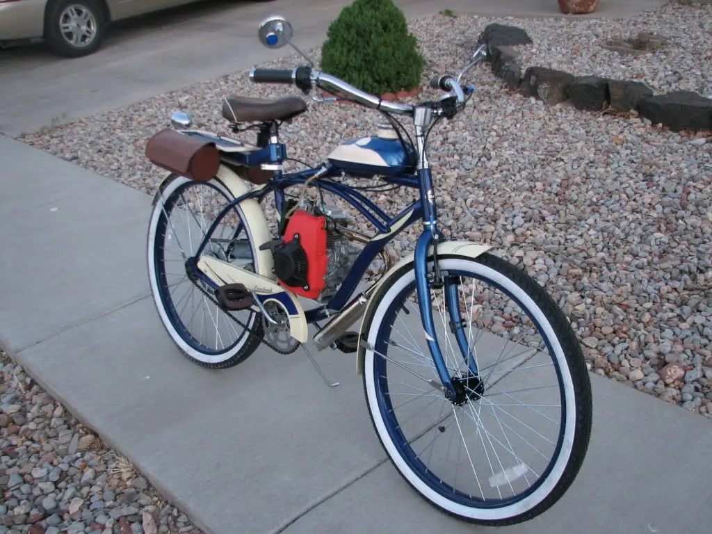

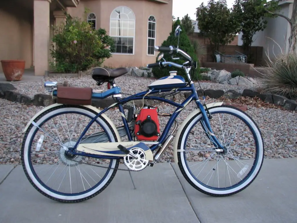

Finally got it running! Very fun bike. I now plan on learning about 2-strokes! I will post pics soon.
Hey, very nice looking bike and a clean build too.
Paint that red cover and put some flex exhaust on it like
Motomagz and it will run better too.
http://motorbicycling.com/f38/monark-build-4-stroke-shift-kit-28004-3.html#post275664
I will be shocked if that JL Hoot gearbox holds up though, good luck.
How is it running? Is the box noisy?
WARNING: Reinforce that front fender cause when the flimsy bracket snaps
you will be catapulted over the front wheel

Thank you! I will look into the flex exhaust. Thanks for the tip! The gearbox is running okay. I meshed the gears better and put in some lithium grease. I need a heavier grease because the lithium grease broke down and just melted to the bottom. Also, yesterday i was tightening the screw over the clutch and small gear (it kept coming lose and the clutch would screw up the pull start and lurch the bike forward..) and i snapped the screw. I will have to back it out somehow...That stinks..but it runs well and gets some good speed!
Oh, and i got the bags on ebay for 5 bucks each with 5 dollars shipping! Sweet deal! I put all my tools and things in there.
