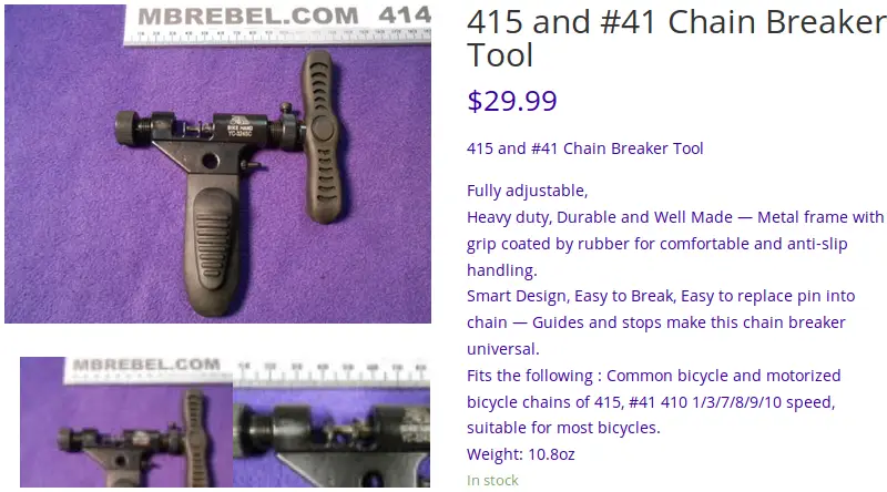

I found the add that you fellas might be interested in on a chain breaker that looks pretty heavy duty. I spent more than
the price on this one that won't touch a 41 link without bending the press pin. Here's the link and information.
Dennis
https://mbrebel.com/product/415-41-chain-breaker-tool/
