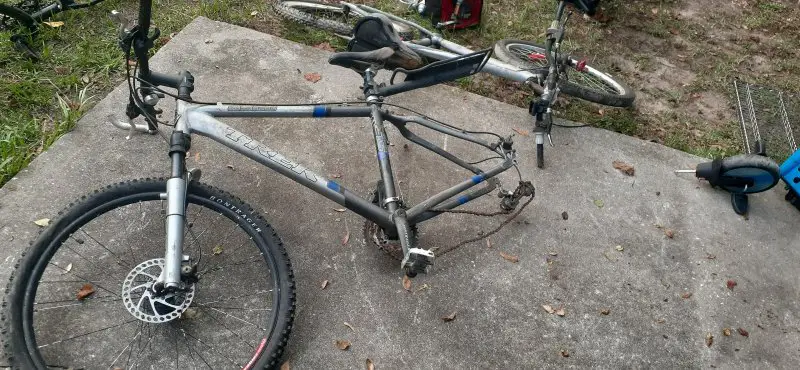

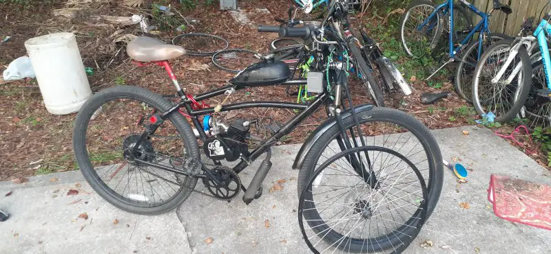

I want to put a smaller sprocket on my bike as well but I'm changing bikes I'm taking the motor I have and putting it on a different frame because the frame that I have now has 27 and a half inch tires and somehow they got warped or the back one did now I'm taking it off of my frame that I have and putting it on a trek 6500 with disc brakes and all that I'm fixing to order a 36 tooth sprocket what I would like to know is will it hook up with the same bolts and grommet and back plate as I have already? I'm going to post pictures of both bikes the next question I have is how will a multi-year bike work with the 80cc motor y'all please let me know tell me what I need to do I'm learning as I go I have done oodles and oodles of reading so I'm learning but I need some people that know what they're doing appreciate it y'all
