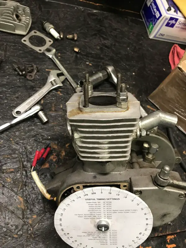

This is how I check port timing.
That seems to be very useful, where did you find it at, or did you have it printed off?

I printed the wheel and glued it to a dvd, it is accurate enough for what I’m doing. Both of mine use the type B piston, the 40mm stroke I converted to the 49mm iron sleeve.
