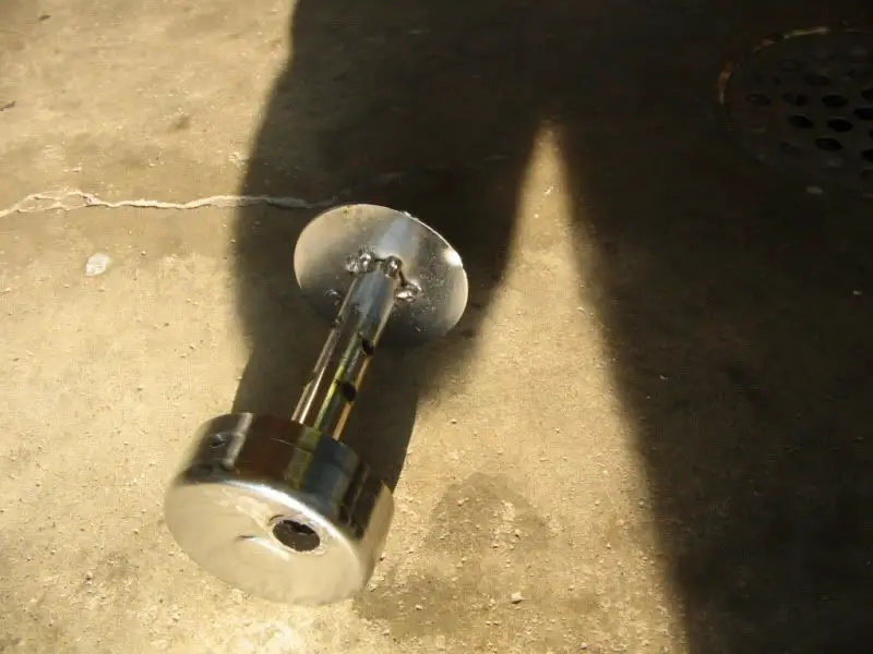

Mine sounds very similar to the second bike. Both of your bikes are sik btw \m/ do I need to keep the baffle plate, or just drilling holes is better? And ill def be trashing anything I find inside that's not absolutly needed to make the engine run. I'm not looking to do 50 just would like to see 30 other than going down hill or least get it to wind out a little better

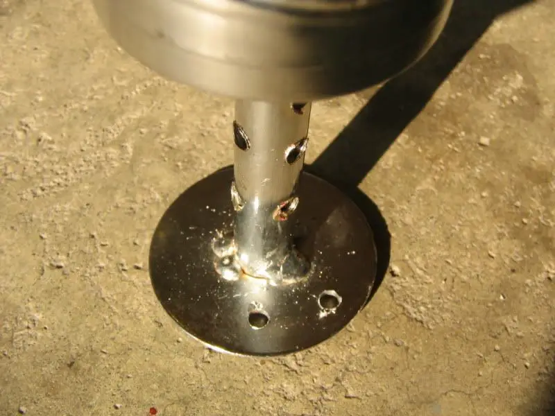

here's what the baffle (the long tube) the end cap and the baffle plate(disk) look like.
they are all welded together.
I drilled 2 holes just in the baffle plate (the disk) on the opposite side of the end caps exit hole.

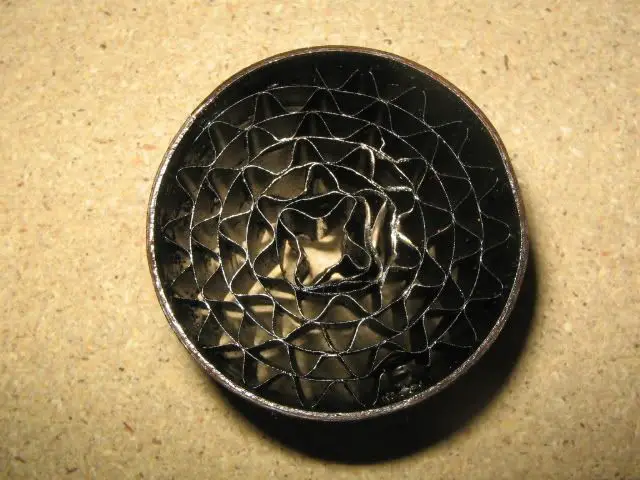

here's what the cateletic thing in the muffler looks like.
it;s stuffed way up in the muffler by the head pipe, and on my mufflers it was held in place with a single screw that's accessable on the outside of the muffler. not sure if your has this, or if it's welded in or what.
but, all i did was take the screw out, and it fell out of the muffler.
I'm no expert on this, and there may be a better way, but this is what worked for me.

Ok - so I took my muffler apart and it looks nothing like yours except it had the cattalitic converter screen inside. The screen was what was making the noise inside. It was also smashed closed in a few spots. I took the cap off the end of the pipe and the screen out and ran it through my parents hood ( is like a 5 mile circle). Omg it was stoopid loud, and I liked the way it sounded. It blew the carb off while I was making the circle. I put it back on and then I blew the air cleaner off. Still never wound out. When I got back it I put the endcap back on and welded it and it made it quiet and still pretty much the same. Low- mid rpms ran great with absolutly no top end. Road is pretty much flat.

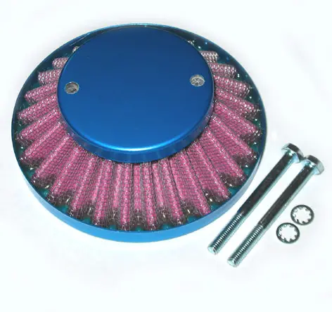

On the air filter... I see you have the clamp on style, and the one you have isn't particularly low profile...
When you pull the filter off the carb, are there screw holes to mount an air filter? If so, you may be able to run the same air filter I got from SickBikeParts.com pictured below. It is super low profile, its bigger around to allow the surface area for the filter so it doesn't have to be so deep. I don't know why they didn't do a side shot of that filter to show just how thin it is....
