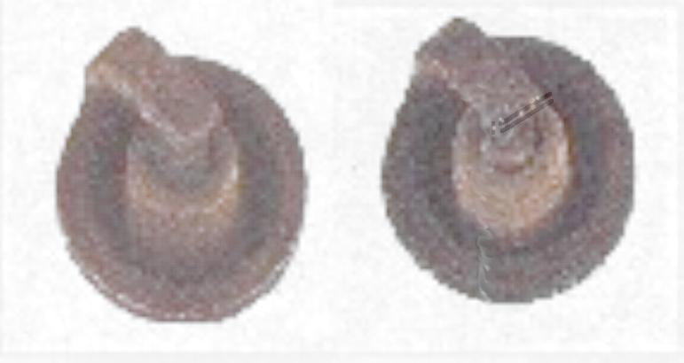

It's hard to find a site that details reading 2 stroke plugs it seems. If your plugs are wet and black you are too rich with oil and fuel. You don't need a photo to know that.
This view is of plugs from a 2 stroke engine. To the left is an acceptalbe plug
and to the right is a good running plug. I drew some black lines on the ground electrode to try and better define it from the center electrode.

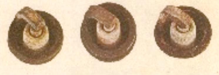

These three plugs may be acceptable for a 4 cycle engine but would be far too lean and hot for a 2 stroke engine. If you pulled these out of a 2 stroke it would be a sign that you need to enrichen your carb or check your ignition to see if the point gap and timing degrees BTDC are set properly. Plugs that look like this could signal failure, perhaps burn a hole in your piston etc.
