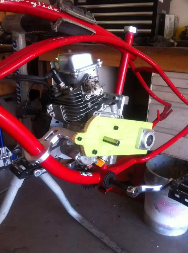

I am using 1/2" Aluminum plate ( not bar stock ) I am working on the trans mount now, I should have pictures buy this weekend.

Is the gap between the backside of your clutch bell and the trans plate tight? Like .060" or so? I'm thinking of re-doing my driveline using a trans plate, but am worried about the small gap. Did you have to shim your clutch any?
thanks, Ed
Bill-
thanks, Ed
I have Allen heads bolts counter sunk into the trans plate, but they
stick out about .200 with a lock washer . so I put a shim on the
crank to hold the clutch about .150 away from the Allen head bolts.
I ran it closer on my old bike but as the clutch broke in it had a
little more side play and would hit the bolts .
If I can figure out how to up load I will post some pictures, My photobucket
has changed and I can't download pictures for some reason.
Hope this helps.
